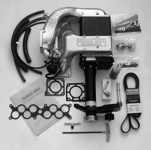

nice kit, but you are looking at about $5000 when all is said and done with a polished kit and a meth kit vs about $3k for the V3
FoxMustangLvr
I love my Pimp
SN Certified Technician
Oct 14, 2012
4,968
3,514
204
Spokane, Wa
Apr 16, 2018
#44
  • Apr 16, 2018
  • #44
Sounds correct for a brand new KB but the V3 either needs to be intercooled or have Meth added to it as well. You'd have to run low boost (6-8psi) or stay out of boost most of the time to avoid high IAT's even with a centri. I read all the time about Centri ppl having to combat high IAT's. Compressing air creates heat, regardless which method (ie. centri, turbo, twin screw, etc) you use to do it.
Of course neither of these prices include other mandatory modifications required when supercharging. It's friggin expensive to go fast.

Waking the dead. Did TPS ever make good on these kits?
Reddevil91
Mar 3, 2010
1,630
773
163
Jun 4, 2019
#47
  • Jun 4, 2019
  • #47
From what I know and talked with Mike from KB they are rolling out some product as of now over to TPS. I asked them if it was just blowzilla or if flowzilla was an option and they stated they believe only blowzilla. Talked with TPS owner mike and he claims they are short on product due to high order and yes flowzilla is an option, but he also told me this last year when these were suppose drop around this time. So idk who, or where he is getting the inlets let alone the manifolds to be able to switch the bypass. 4000 for the blowzilla plus 500 for the flowzilla upgrade, 4500 for it seems so high. I know it’s a solid piece and does it’s job. The bad thing is it’s still 90s platform technology, wish they would have revamped the unit and update it to run some sort of intercooler etc. I’m tempted but at 4500 is it worth it?
FoxMustangLvr
I love my Pimp
Oct 14, 2012
4,968
3,514
204
Spokane, Wa
Jun 4, 2019
#48
  • Jun 4, 2019
  • #48
I wouldn't pay $4,500 for a Flowzilla. Why the F@@K would they produce these again and not make the inlet capable of being intercooled? It wouldn't be much more work for them to do.
Sorry but during the summer when ambient temps are 90* my twin screw is putting out about 160* IAT's at cruise and idle. Spraying meth doesn't fix that, only intercooling does.
In early Spring and Fall when the air has a nice crisp bite to it in the mornings my Kenne Bell is a freakin' hell raiser. During the Summer it's a lazy biotch unless you spray it.

There's no chance they'll make an intercooler for this now. Folks wanted one when this kit was all the rage too... Nada.

Reddevil91 said:
In my head, the alternative is water/meth shot directly into the pressurised manifold.
I want to machine one, maybe two, bosses into that manifold. One of those bosses might find an N20 nozzle to house.
That aside, I still think the KB 2.1L Flowzilla is the [perfect] blower match for any street driven, stock 302 long block. Once you start adding heads and associated mods the choices become more difficult.
I would wholeheartedly recommend this kit to anyone who wants to remain stock with more HP to include Fox Cobras. Relatively simple to install, and very simple to put back to stock. Supporting mods include (to do it right) 255L/hr High press fuel pump, 42 lbs injectors, wideband, and a tune. Optional: Anderson 4" Power Pipe, elbows and couplers, clamps, 90mm MAF, 80mm TB and spacer (Accufab), exhaust.
Cheater method: 255L/hr High press fuel pump, Fuel Management Unit, wideband
Highly Recommended: Boost-A-Pump regardless of what fuel pump you use (this is more about crappy electrical systems than about the pump)
With all the optional mods, this blower can split an OEM block down the lifter valley. It is however, uncommon.
