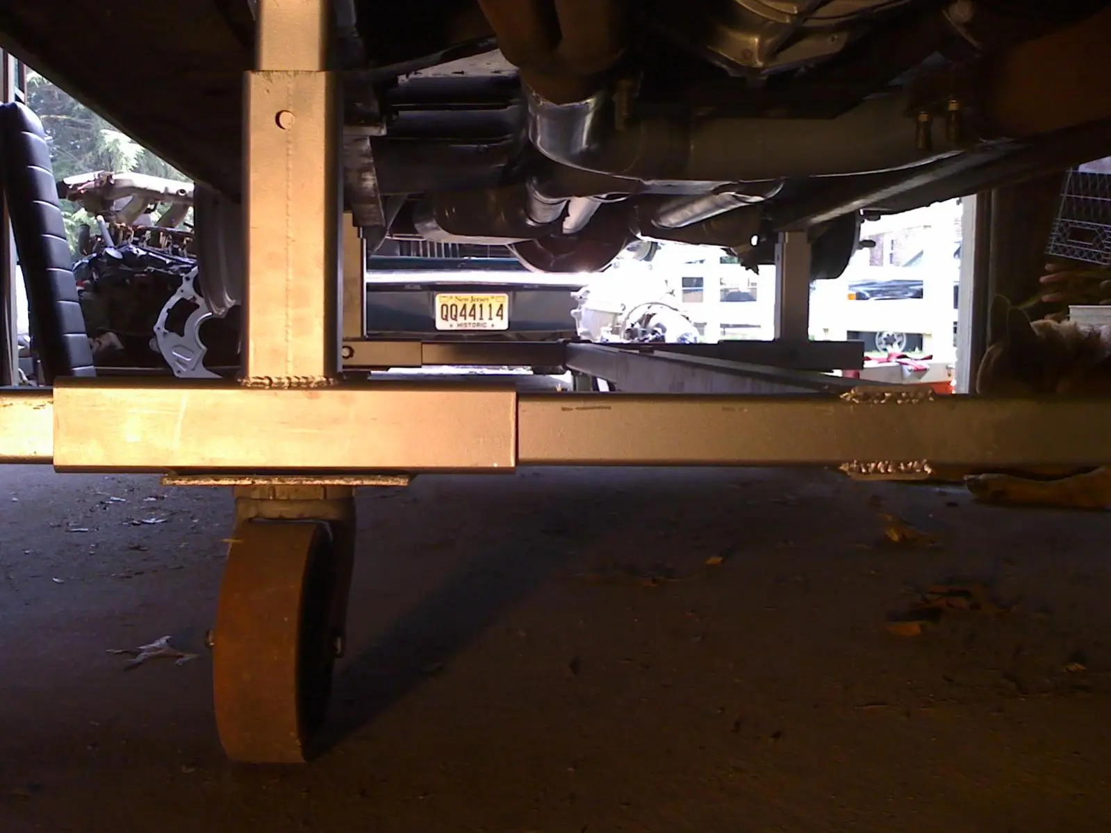

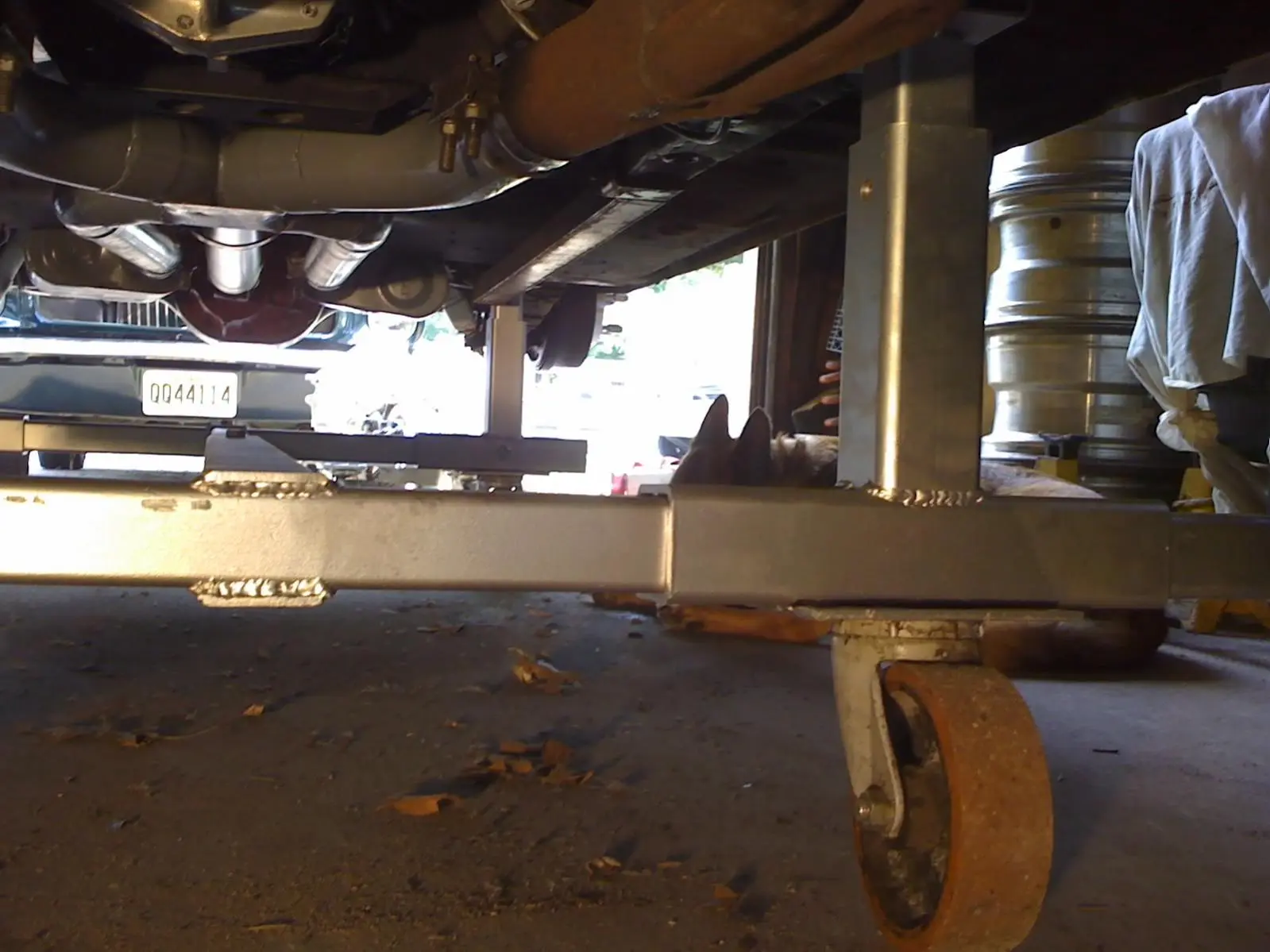

this is with my 66 coupe on it fully loaded. I used 2.5" o.d., 1/4" wall square tubing with some 2.5" i.d. tubing for the mounts. Everything is adjustable to fit various frame widths and lengths. I had my 69 Falcon wagon (fully loaded again) on it for a while before the Stang went on.
