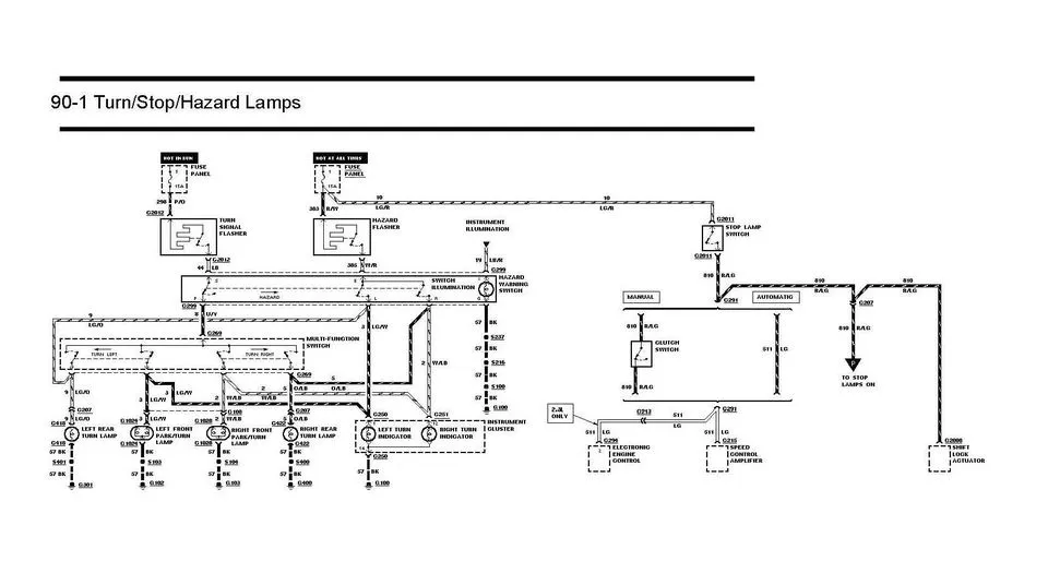

Hey guys, I have a 87' GT that the turn signal on the drivers side does not work at all. The hazard's all work but just no turn on the drivers side. I replaced the flashers, the entire acc unit on the steering coulumn, checked fuses, etc, etc. I'm great with wiring but the Haynes manual diags for the fox stangs SUCK. They are too damn small. Does anyone have a copy I can read? Or any ideas on the issue would be great!
See if this helps.
