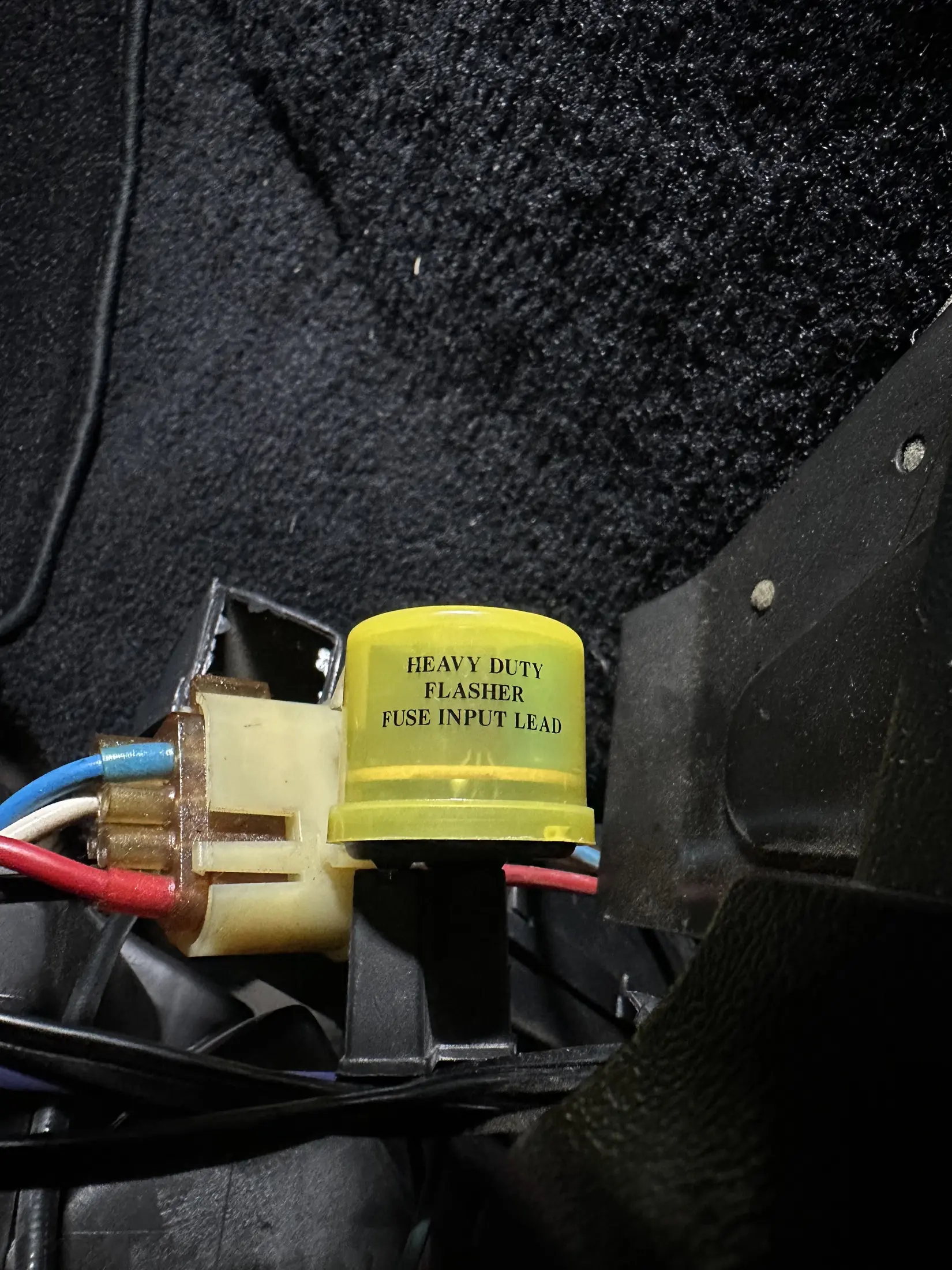

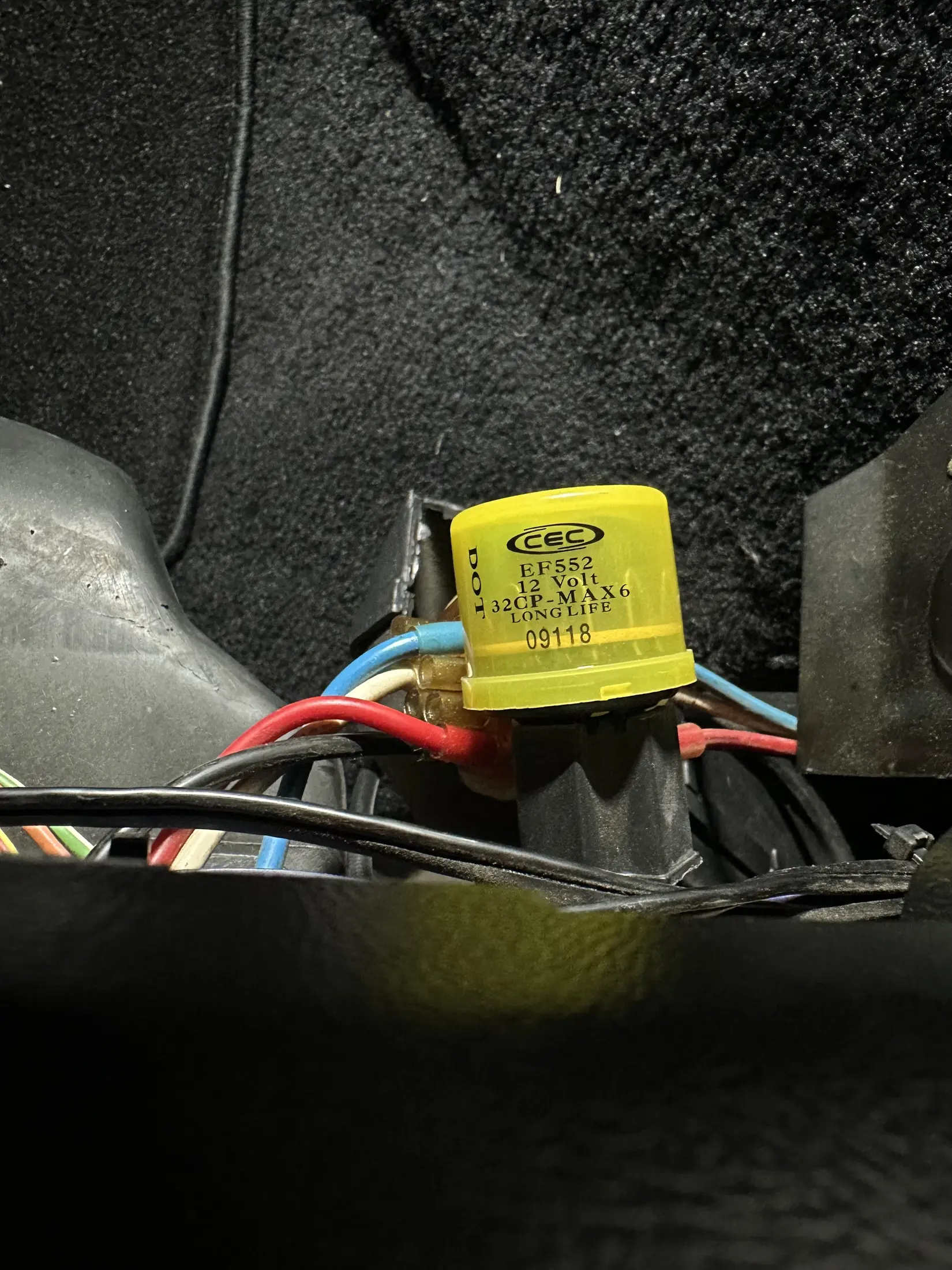

Let me go out and take a picture of the one I put in the Coupe. I stand corrected I just used a CEC heavy duty flasher. It is a clear yellowish color so for some reason I had it in my head it was a digital one. Looked them up and I did not remember a ground wire which mine does not have. This solved my emergency flashers being super slow. The flasher hangs upside down to I rotated the pics to make it easier to read. Just wanted to point that out in case things looked weird.

Yeah the flasher doesn't have a dedicated ground. Where can I check grounds?
I would probably start by making a temp ground to the ground pin on your relay. Just a wire that is grounded really well. Test the relay. If it work then start troubleshooting the ground wire back to the connection or chassis.
A trouble light can help with this.
