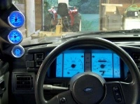

White face during the day:
One of 6 shades/colors during the night,
I have my C2 guages dimmed alot in that pic. The C2s are so damn bright on "full", that you can't see out the left side of the car. The white face cluster is on a totally different dimmer, which is the one the kit came with. I'm happy it did! If I had to wire the cluster with the rest of the lights(Which the C2s are), I would be pissed.
