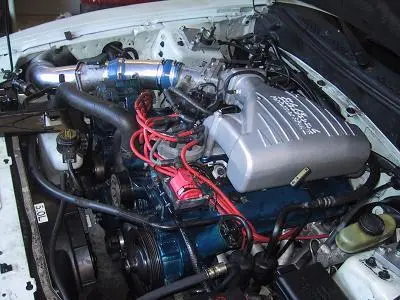

I bought one on Ebay, Scratched the crap out of it. And had to dremel out all the threads for the IAt so I could stick it in. Called them about it and wasted time talking to the saleslady who had no clue what I was talking about. Does free up some space in the engine compartment as well. I bought my kit from racing_guys was expecting to at least be able to fit the sensor in. Oh well it was cheaper than building one but it cost me over an hour to dremel out the boss so the IAT would fit.
Yeah, not with mine. You could probably do that... it would strip out all the threads on your plastic IAT sensor which would never screw into another intake tube. I chose to dremel out all the threads in the intake rather than ruining the IAT threads. Cheap ass intake tube versus an IAT sensor which Ford prolly charges and arm and a leg for. Hell it barely fits in now with no threads at all and boring the hole at least 1/16 wider. Maybe you all got better kits, I figured they were all the same supplier and would all be the same crap from china or taiwan.
Well I guess I should say that I used vice-grips now that I think about it. They were on tighter than a.......anyways, so it didnt strip the threads at all. I didnt have a table mounted vice, because if I did I could have used a socket and done it that way.
The threads of the IAT sensor inside, not the bolt type hex used to screw it in. I'm starting to think their are a lot of cross threaded IAT sensors out there. SHouldn't need vice grips or a vice if the thread pitch and diameters match up. Like they always say if you have to force it in somethings wrong. For me it was definately the wrong diameter boss for the IAT, may have been different for others.
