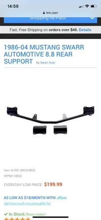

Is anyone running this? or the Panhard and torque arms, or all three? First time building rear suspension and help some good knowledge and help

More of a drag racer mod. High HP plus sticky tires.
However at that power level you should probably just weld the axle tubes. This looks like a stopgap solution.
PHB and torque arm would be geared more towards road course. What are you trying to set the car up for?

Weekend car with a few passes a month at the strip
Welding the axle tubes is a must for putting any real power down on slicks at the track. I had a nitrous car and tweaked the tubes with only about 350 - 400hp ( guesstimate ) and twisted the studs. I avoided that catastrophe but destroyed the axle housing.
For serious power 500+ I would get the rear gurdled....or just put in a 9 inch in and not worry.
A good set of axles...c clip eliminators...and welded tubes will go a long way.

I’ve heard that welding the tubes weaken the rear
Welding the tubes will not weaken it if done properly. I've never seen a welded one break. You'd want a professional to do it.... or at least someone that can really weld. There's a rivet that has to be welded, too. Don't forget torque box reinforcement while you're there.
Mine was done by a local guy that did a bunch of race chassis work. He had a jig just for welding 8.8 rears.
Not if it’s done right and in a jig . I did mine myself with my buddy years ago and it’s fine and we didn’t have a jig. Little common sense goes along way as far as keeping the heat even . A welded tube 8.8 with 9 inch ends will support 4 digit hp without blinking .
If you're not the " best welder" then you should leave it to somebody that is. Welding the tubes requires a process, and somebody who knows what's gonna happen when they put that much heat to the axle tubes is a must.
An 8.8 that has lived a hard life will have tweaked tubes. Some are so freakin bad you can stand over the rear end and see how far forward, or twisted, or forward and twisted each tube has pulled at the brake end. ( usually a rear that had slicks on it)
Welding the tubes, welds dissimilar metals together ( usually never works) but in the case of a ford rearend, somehow seems to work beautifully. The welder you use has to be capable of welding 1/4" stuff, and typically would mean that it's not gonna be a 110v piece. Once the welding process starts, you cannot stop.....The weld bead has to be continuous all the way around, or you'll be able to literally watch the tube move one way or the other as heat from the weld will pull on it.
Unless you plan to drag race the car regularly with sticky tires I'd probably pass on that though..the same for the brace that you've pictured.
On the other hand,....if you do intend to drag race it weekly, than do both....welding the tubes will not stop them from bending,..the brace will. That brace is intended to do both w/o welding the tubes, but if using it, I'd weld the brace on, and forget welding the center to the axles.

Unfortunately there isn’t a real chassis or even race shop where I’m at and don’t want to drive hours to one, so I fell a brace is best just to be on the safe side. I also found this one. Think it could be better?
