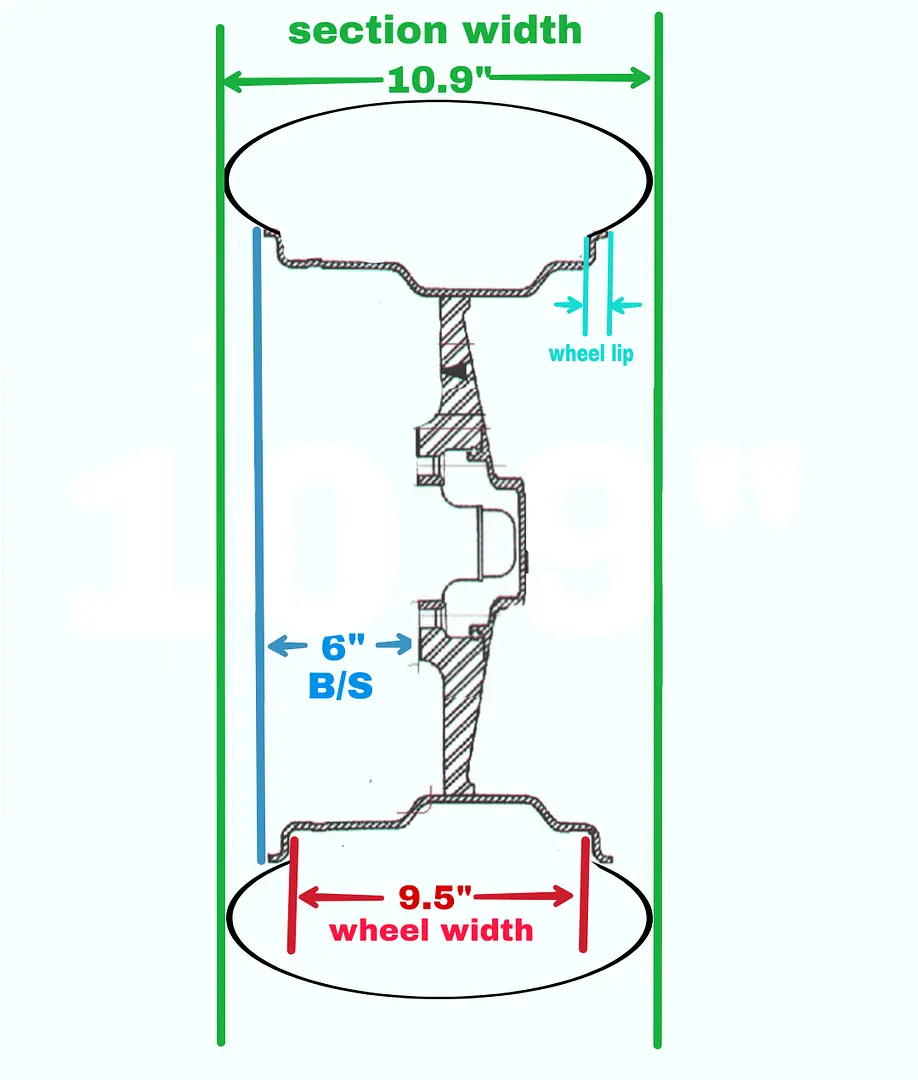

I've built a few chassis from scratch. Figuring this out is an important step. Especially when you're having an axle housing narrowed and axle lengths custom made and figuring out wheels and backspacing so it all fits and looks right. Some times having a deep dish wheel fits the build, sometimes not so much. So figuring this out is a big part of a scratch build frame. I can share what I've learned. It does require drawing it out if you really want to do it right and do it once. Here's how.

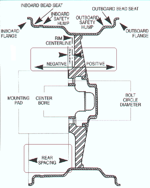

It's important to note that wheel width is measured from the inboard BEAD SEAT to the outboard BEAD SEST. Backspacing is measured from the wheel lip to the mounting flange. Here's an image.
So remember when you measure backspacing from the wheel lip to the mounting flange you are including the thickness of the wheel lip, which isn't measured in the wheel width. Wheel lip can measure anywhere from 1/4" - 1/2".

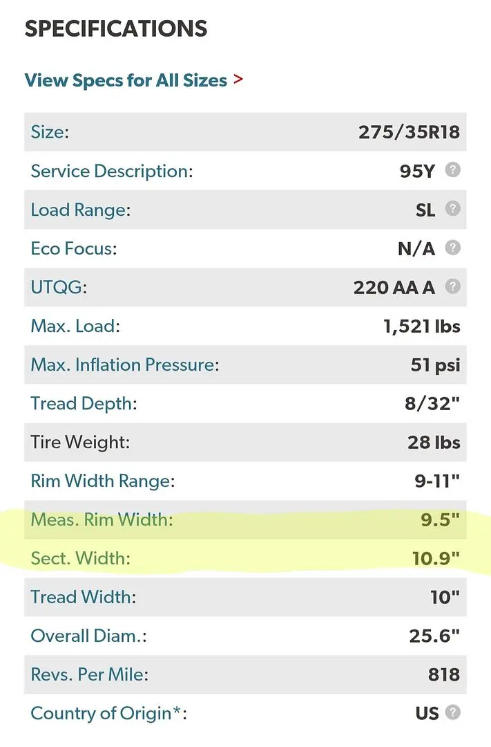

To figure out actual wheel and tire width go to a place like tirerack.com (https://www.tirerack.com/tires/tires.). Search by size. Click specs tab. This will give you the a chart like this:
Different brands and makes have different measurements. You'll be looking for the "section width" measurement. Thats how wide the tire is at its widest point at the sidewall. This example is for a Goodyear F1 in one of the sizes you listed. It's measured at 10.9". This is on a 9.5" wheel.

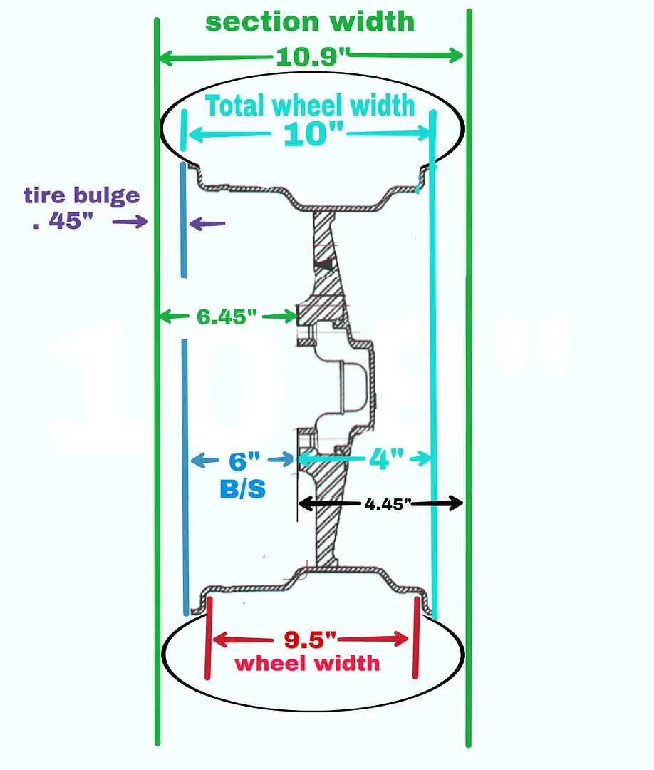

Heres a quick scribble. We'll be using a 9.5" wheel with 6" backspacing for all of them.
So in this example you calculate total wheel width which equals the advertised width (9.5") plus the lips on both sides. This varies each lip could be 1/4"-1/2". Already having the wheels in your case makes this very easy. Just measure them. Let's say they are 1/4" each side. Total wheel width = 10.0". (Or 9.5 + .25 + .25 =10 )
Total tire width (section width) = 10.9"
10.9" - 10.0" = .9
The tire is .9 wider than the wheel. Divide this in half will tell you how much buldge sticks out past the wheel on each side. In this case .45

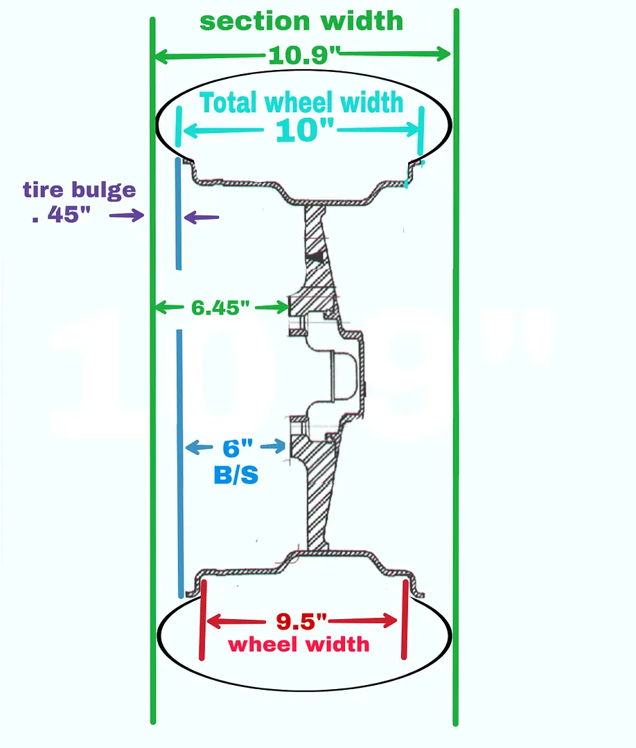

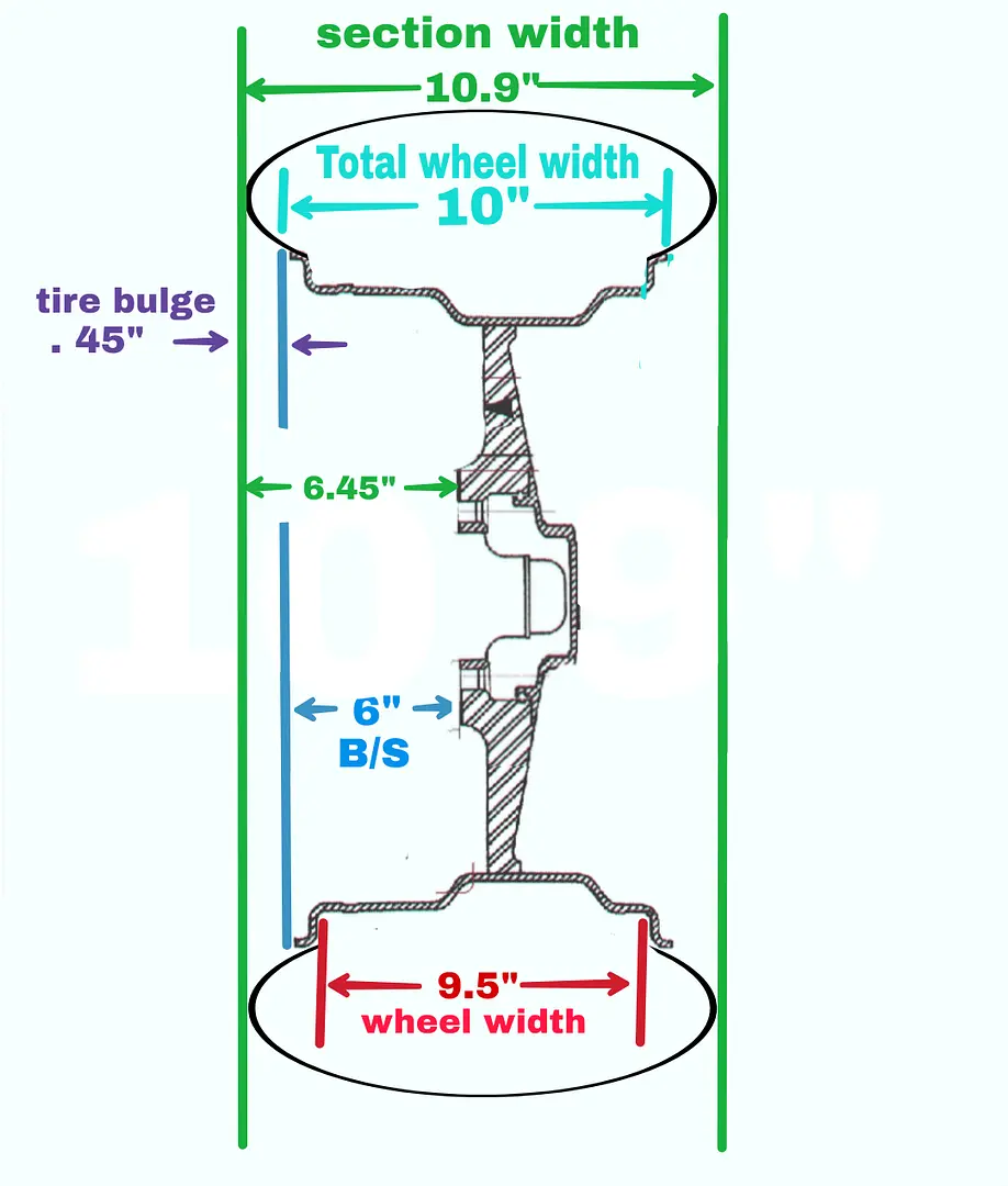

So let's add that to our drawing and see how it effects backspacing
So here you can figure the distance from the mounting flange to the widest point of the tire sidewall.
To figure out the distance to tue outboard side you just use the same math. In this example the measurement from the mountong flange to the outside of the tire sidewall is 4.45".
So if you add the 6.45 + 4.45 it equals the 10.9 section width.

Thanks Nick, I've done a lot of what you are showing. Just without the fancy drawings, lol.
I usually use tirerack for the tires and https://www.1010tires.com/Tools/Wheel-Offset-Calculator and https://www.1010tires.com/Tools/Tire-Size-Calculato
I don't have a wheel tool, just didn't think i would need it in this case because i have the wheels themselves. But if i have to buy/borrow one, i'm not opposed to it.
When i get them back today i'll measure to the from the existing rim to the tub and then install the 10mm offset and see how they compare.
If the calculations are right, the new wheel should be 3/4 more outboard.
The F1 is a good example, considering I may want to run the F1 3R.
Thanks for the drawings.
The bulge is i believe is what i was having the most issue with, mainly because i have a lack of faith in width specs.
Right now the tire bulge is 13/16 (.81) per side (measured with a straight edge and tape to lip). So that should give a little more room.
With a number that high you can see why i'd like to widen the wheels.

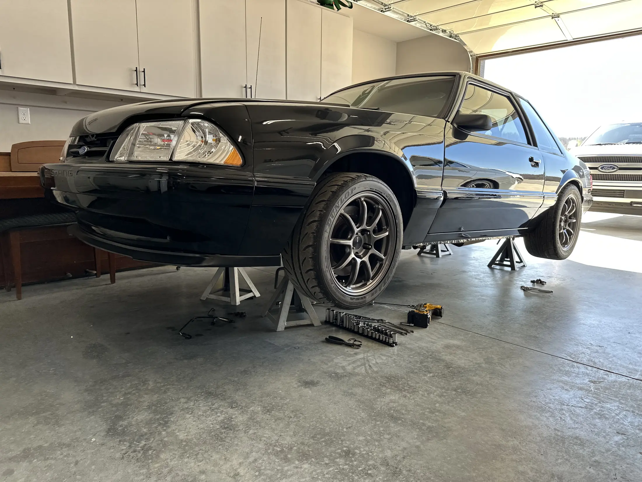

So I swapped out the wheel today.
At it's closest spot (for the rim) the new wheels have about 2 inches on either side of the car before accounting for a widened wheel.
In my head, measuring was going to be super easy, really wasn't with tires on the ones on the car. Regardless, the new wheel does indeed add about 3/4 space.

Oddly enough with the 10mm wheels on the car, the rim is still inside the outer wheel well. Again, with less tire bulge that shouldn't be an issue on the outside.

My hesitation may all be coming from the actual size of my current tires vs their rated size.
Almost seems like the 275 wasn't accurate. Even here where i probably bought them, they suggest a 9-11in rim, which probably means a 10 is optimal.
If that is true, most of what you guys have suggested is correct and where the disconnect is that my experience is with a tire that truly does run wide.
Even with a 9, i just don't think it would be wide enough for what i have now, but the reality it, there is a good chance that is not what the next set is going to be.
It's a 275/35/18 Gforce drag radial (if it doesn't link correctly)
