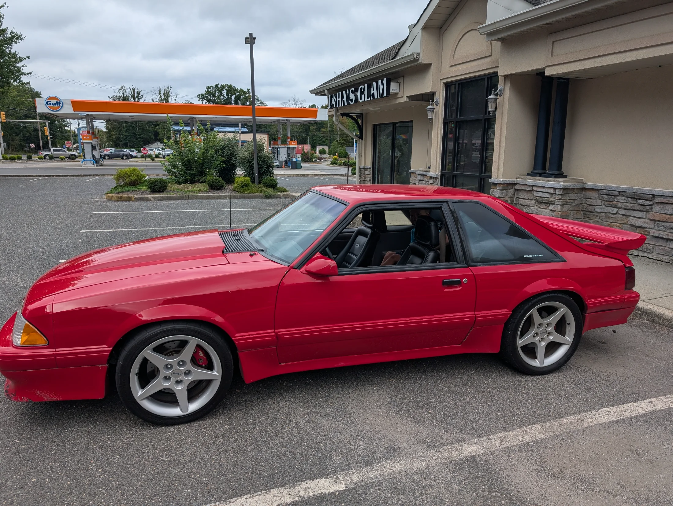

I don't take a lot of car pics, but here is a recent one.

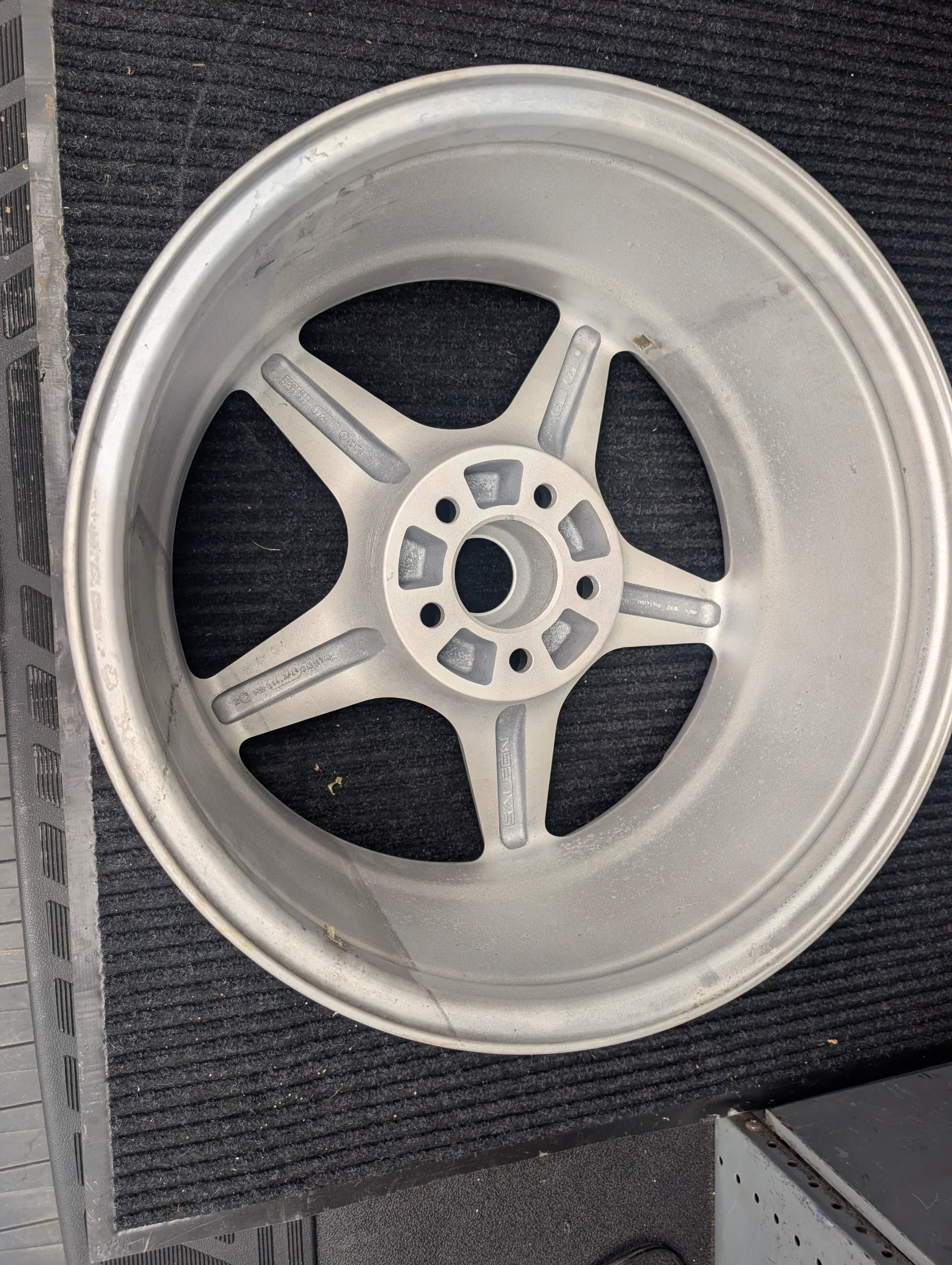

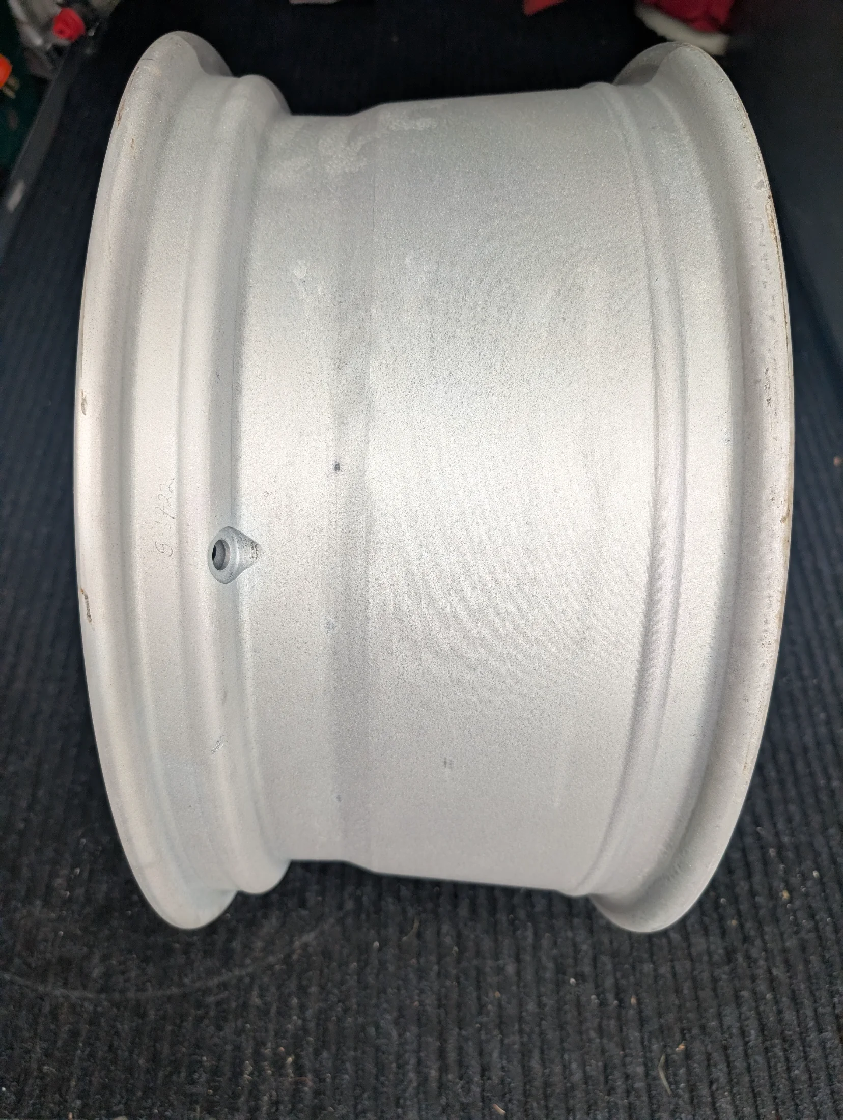

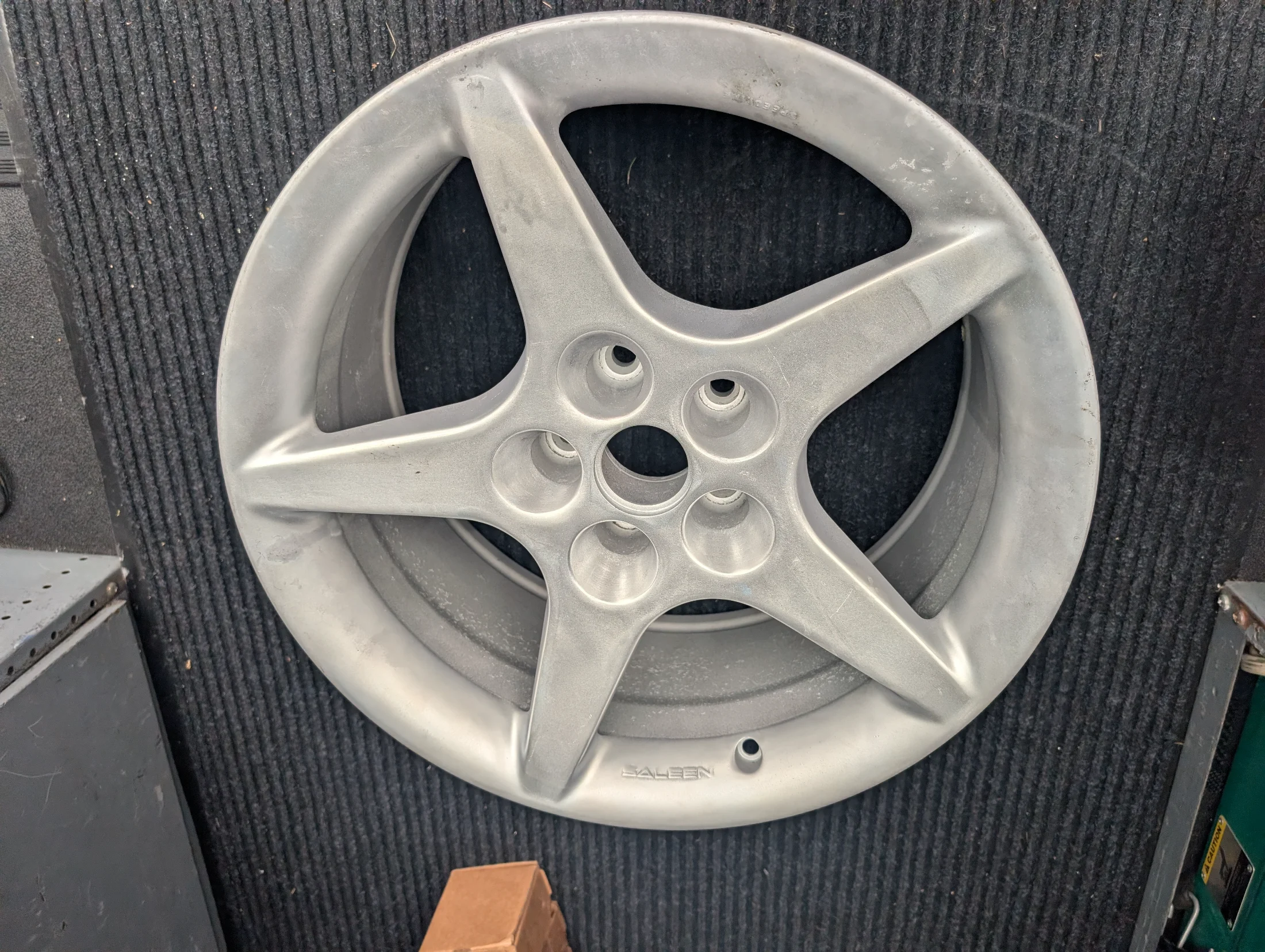

Also some pics of the wheels I plan on having modded. In it's current form it's completely bare aluminum after i had the chrome stripped.
Came out better than i thought honestly. I had the set from my Saleen Explorer Xp8 stripped years ago and NJ winters and crappy saleen chrome work left one wheel pretty much unusable and the rest in mediocre condition. I'm not a fan of chrome or polishing, but something about how this set came out tells me to polish them all. Or go black with a red stripe around the border and put the molding on the car back to black.

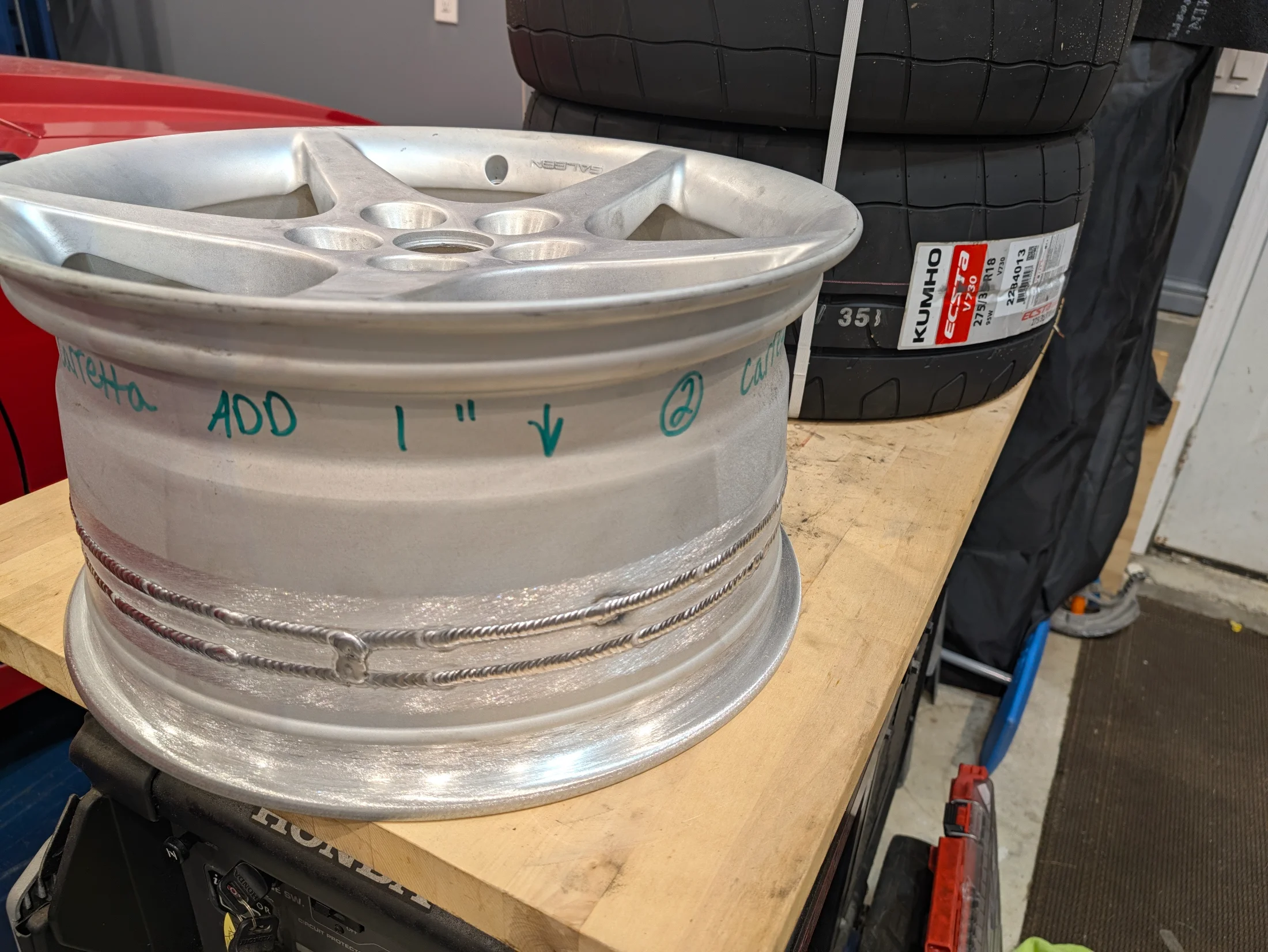

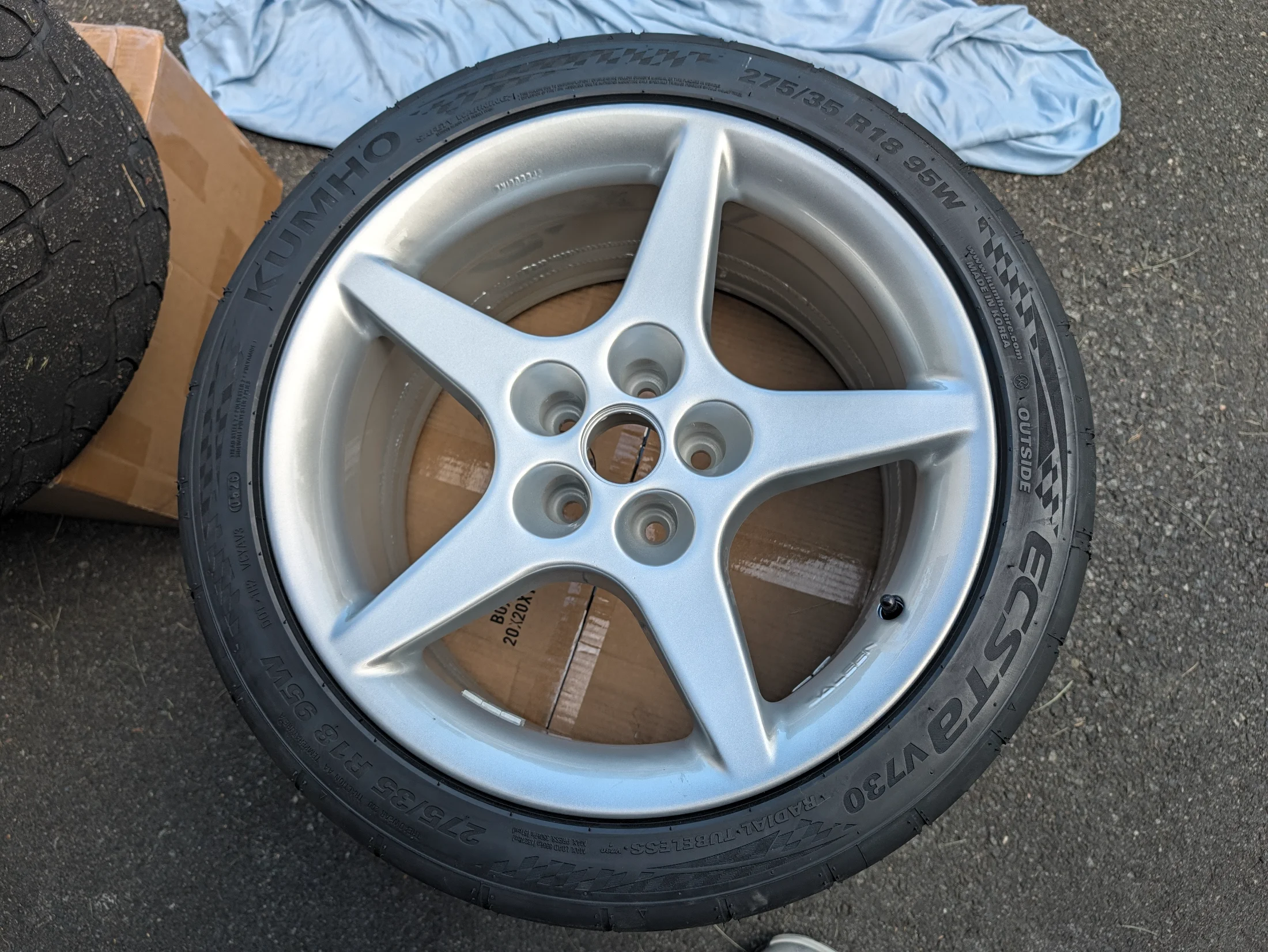

Wheels are on their way back this week. Took about 2 weeks, they said 4 originally.
I'll be having them refinished right away, I have a wheel repair/refinishing place around the corner and they do them in 1 day.
Should be able to make a real world comparison on how wheel width and size affect clearance.
This was done to my spare set and I have new tires so they can be tested back to back with what is on the car now. I also have a spare front spindle I been using as test bed for radial mount 14 inch brakes (just have to bring myself to accept $700 in rotor rings and $650 for custom made hats), I can easily mount a wheel and check to see how things change.

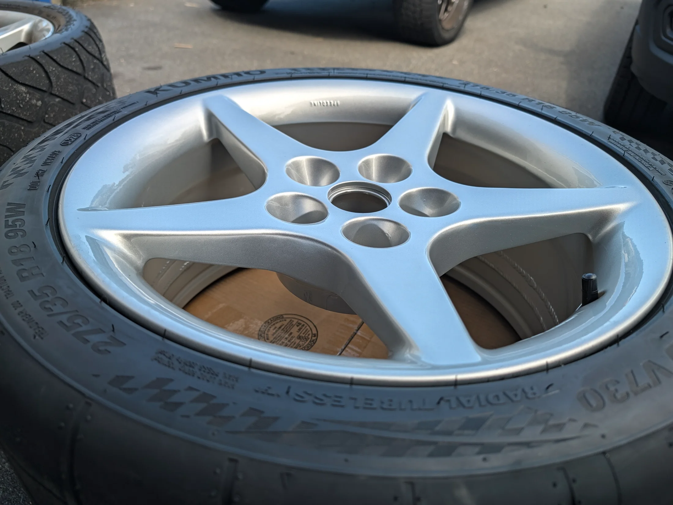

So wheels are done and tires are one.
Judging my the tightest spot where it has rubbed in the past, i've now gained clearance everywhere on the inside. I think pushing the wheel out and then spreading the tire out properly actually got me more clearance than i was asking for.
I'd almost go as far as to say i could have went another 1/4.
With that said, I also feel like 9.5 is the perfect size wheel for a 275 and vice versa so going to 9.75 probably wouldn't have done me any good.

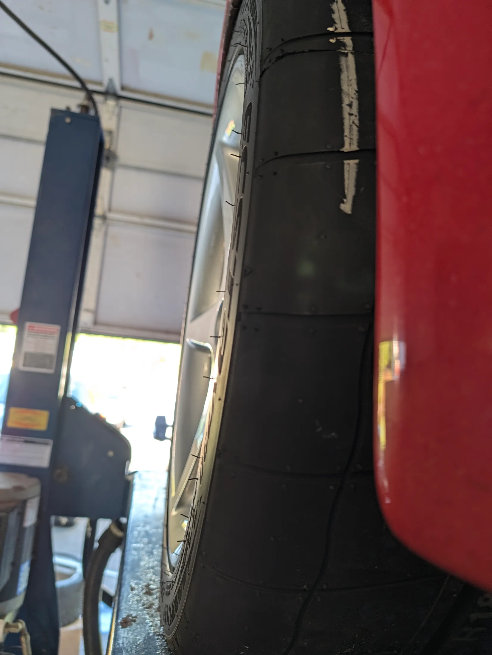

With a level across the tire, the tire sits about as square as it's going to get.
And while i don't normally park near any curbs, if i do, it's not going to take much pressure to scrape a wheel.
The picture makes the tire look a little narrow, i assure you, it's not. The center of the tire sticks out about 3/16 to the lip.
On my other set, the widest part of the tire stuck out 3/4 of an inch.
As far as adding 20mm to offset which pushed the wheels out roughly 3/4, i don't see any issues with rubbing, to my surprise, the tires are still tucked a little bit. I now can see how 10 inch wheels fit on a fox. With the perfect width and offset i could see someone safely getting a 285 on there. I'm not much of a risk taker, so not sure that guy is me.
