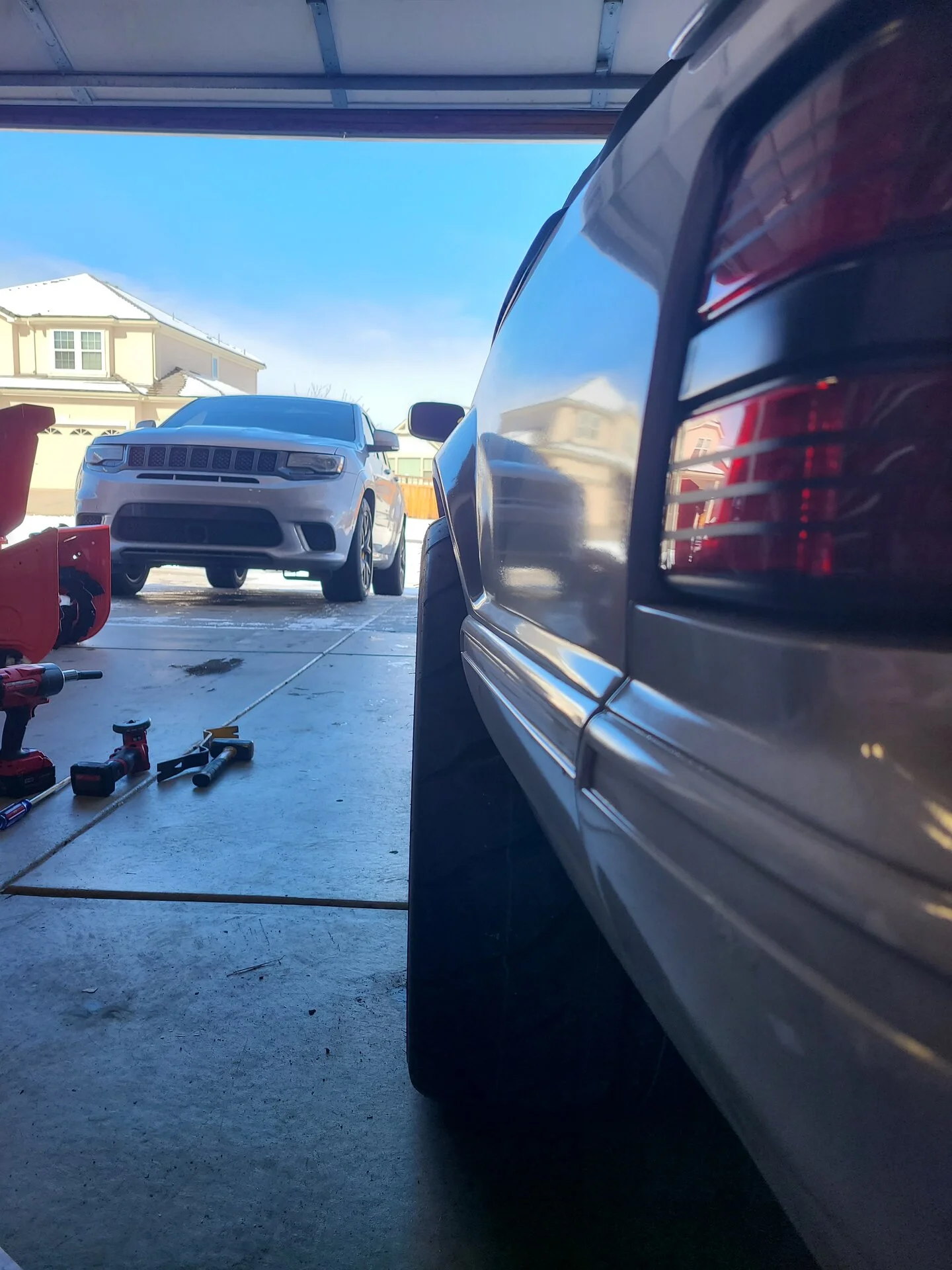

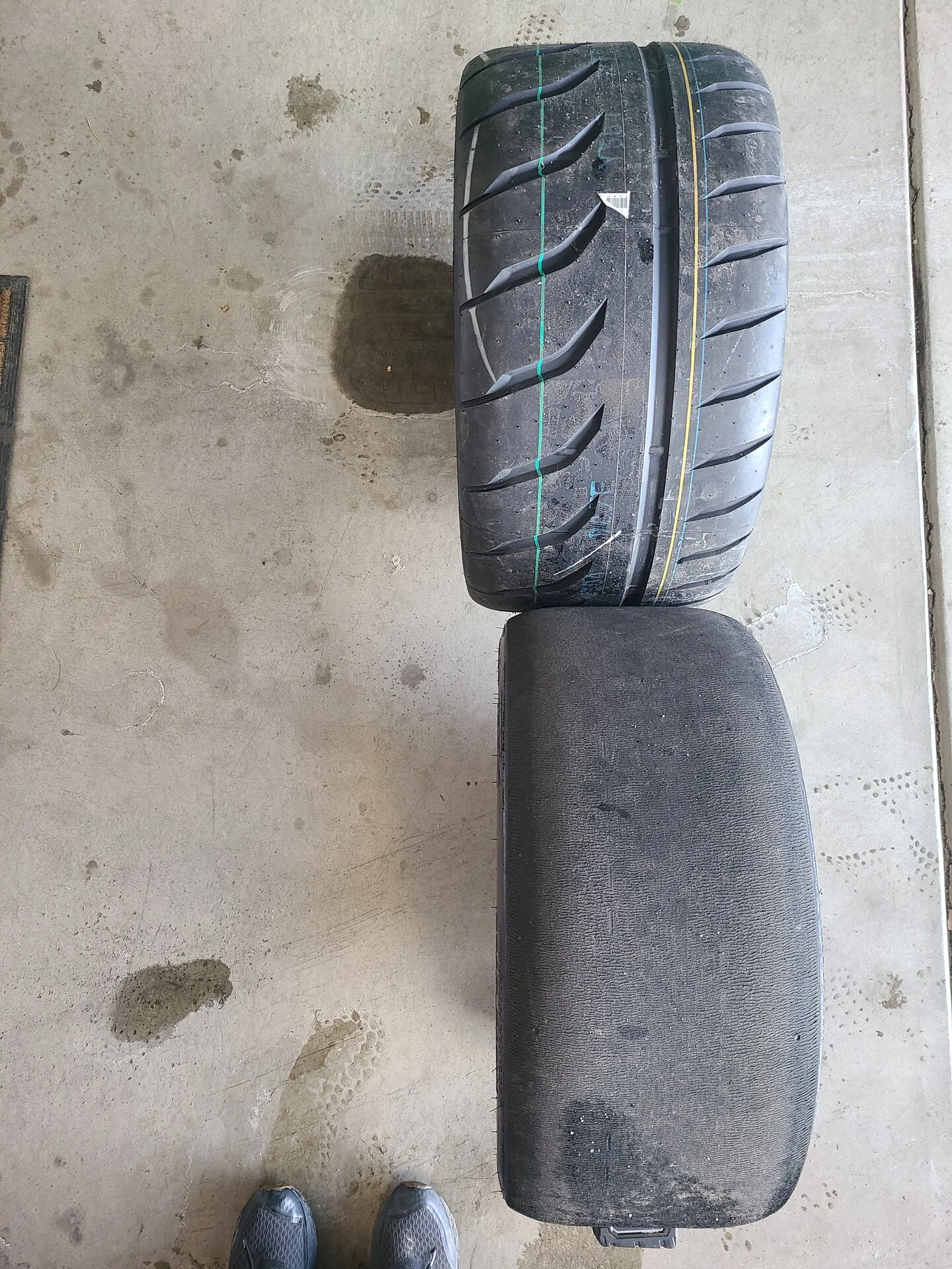

So I'm squeezing a 17x10 LMR Pony wheel in the rear with Toyo Proxies R888R in 315/35/17. It's tight, very tight and I'm willing to sacrifice a little bit of inside sidewall rub on turns for the extra rubber, I need it. My old Hoosier DR 275/40/17 hooked for about the first 100 miles then were garbage. They have a tread width of 9.6" and the Toyos are 11.8" tread width.

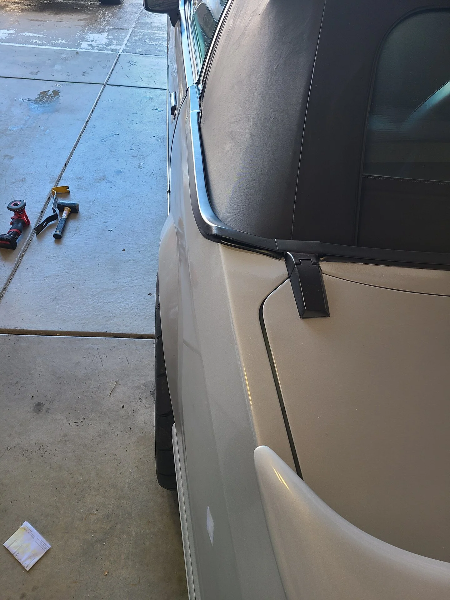

I'm running Koni Oranges in the rear but was thinking, if I went with Strange adjustable rear shocks and set it on the firmer side, would that eliminate some of the rear end travel up and down over bumps and dips? I'm trying to prevent tire rub from the fender lip. With the Eibach Pro's and Koni Oranges, it seems a little soft in the rear end. Thoughts?

Stiffer rear shocks add oversteer. If you stiffen up your rear shocks, you will have less rear end grip than your previous setup. That will negate the benefits of having a wider tire.
Limiting suspension travel will make your car handle worse when it comes to cornering. As an example, I use Tokico Illumina 5-way adjustable shocks & struts on my 1992 GT autocross car. 5 is the stiffest setting. I have my shocks & struts set at 2 F and 2 R. That car runs 245/40/18 tires and has beaten cars running wider tires on an autocross course. With a stock-style (non coil-over) suspension, going too low or too stiff with the springs, shocks & struts will make our cars handle worse. Also, a staggered setup adds understeer to a car that already has understeer from the factory. If this is for a performance driving application, a square setup will perform better.
Reactions: 2000xp8
Stiffer shocks will not reduce the range of your suspension travel. They will make it ride rougher and maybe reduce the speed of the hits and number of times the tires hit the fender lip. But it will still make contact. (Warhorse says why else this is a bad idea.)
Jacking up the rear and adding taller suspension bumpers (or air shocks) 1970’s style will put the lower control arms at a not parallel to the ground angle. That leads to axle tramp on these cars. So wheel hop is more likely to offset your traction and break parts.
Rolling the lips of the fenders is possible if you are determined on running these tires and wheels.
