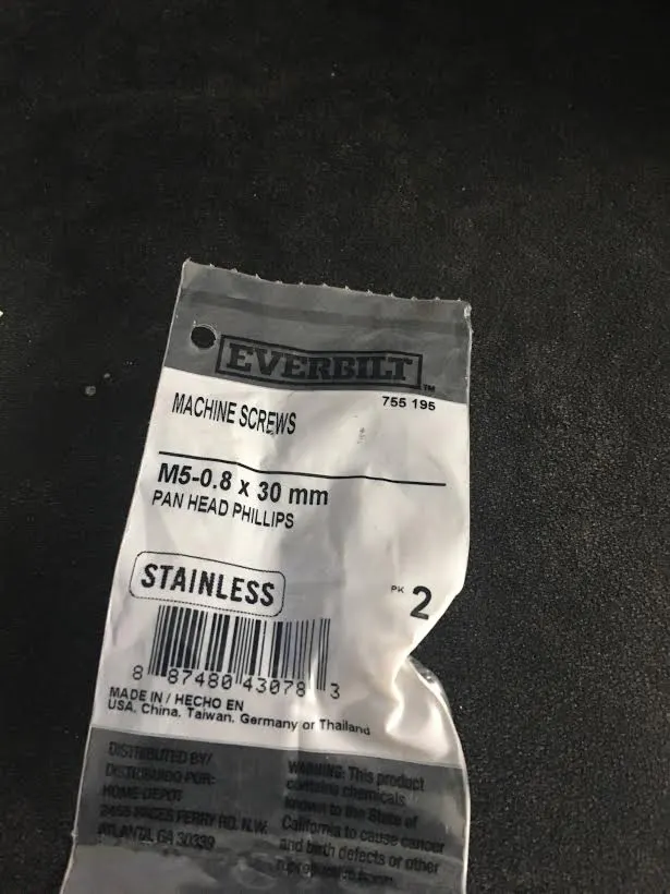

M5-0.8 x 30mm I bought them at home depot
