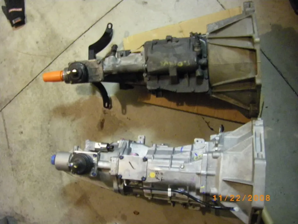

according to the picture I saw, the T56 shifter sat back about 2-3 inches from the location on the t-5, I think it was a GM T56 just because of the shifter location
take a look, this is why I think the toploader bell will work
p.s. this is a ford T5...not sure if the t56 is GM but I think so

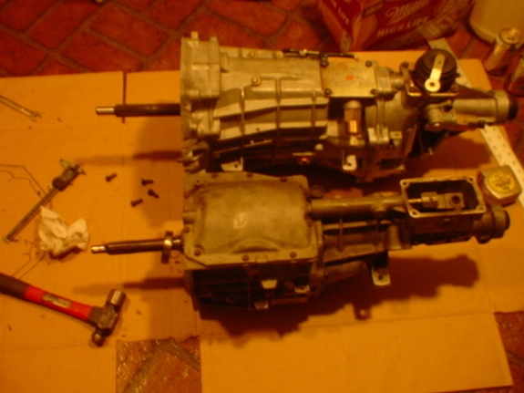

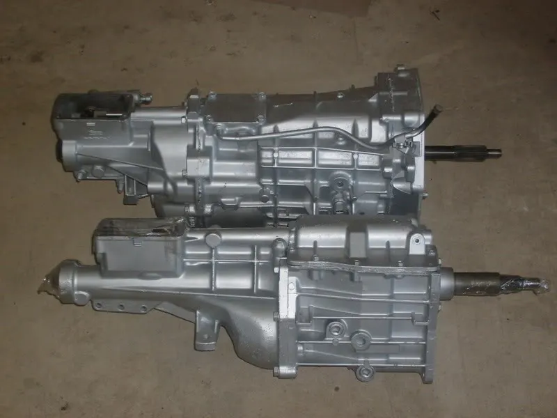

I don't know if this helps but it is a picture of my old T5 next to my new T56. The biggest difference I noticed about the two is the bellhousing is much shorter with my T56. That compensated for the difference in shifter location. Mine came out in the same position. If that is the same for a GM I have no idea. Have you tried going to tremecs website for measurements of the different versions?
The shifter location would be a benefit there. That is probably a GM T56, the shifter handle box is rectangle, Ford and GM were like this. Ford input shaft is 10 spline. The input shaft looks like Chevy T56. If you go with a Chevy T56 try to find out if the input shaft is the same length or close to same length as the Cobra. If so, you won't need an adapter plate. FYI, the Viper, Ford and GM T56 will bolt up to the same bellhousings meaning the bolt patterns are the same.

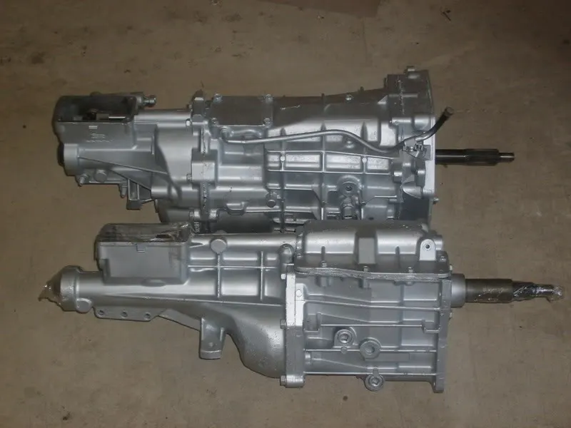

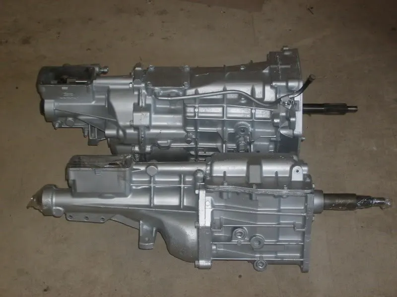

The angle in you pic doesn't show the length difference well. Here's what I did.
Viper T56 VS Ford T5. The mounting surfaces are lined up, and the input shafts are about the same length. I know you're wanting to use GM T56, I'm just trying to give you some reference and ideas.

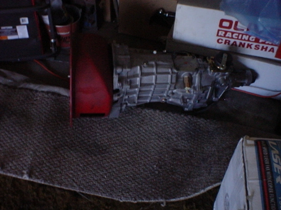

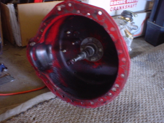

This is the Viper T56 mated to the Ford T5 bell using a Ford T5 bearing retainer to center it.

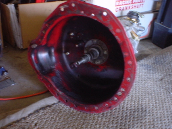

Here's the GM T56 to GM bell adapter.
you would have to center a Ford bearing retainer where the GM one is seen. Also, need to drill the holes to bolt up behind a toploader bell. I believe one of the 4 holes, top right when facing the back side of the bell, overlaps between the Ford and GM patterns.
