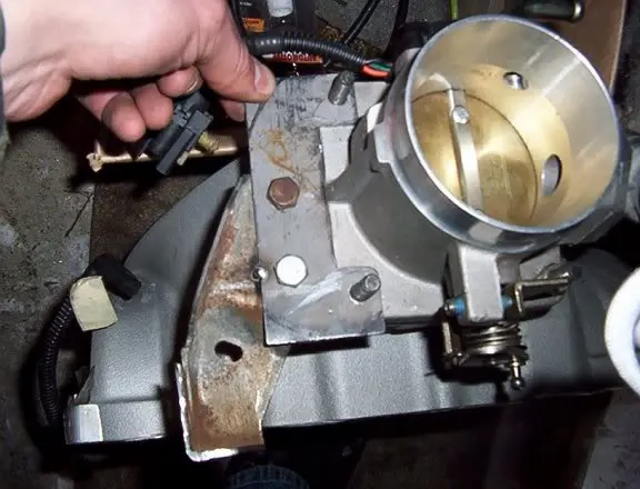

i did and made my own delete plate by modifying the original bracket. i am switching back to the egr cause to do this you need to hack the heater tubes that run along the lower intake and with it like that it looks sloppy. other than that it served its purpose and i never had any problems
this is a shot i took while i was mocking it up. i ended up rounding it off and painting it

i wish i had a better pic of it after i painted it and cleaned it up, it actaully looked pretty good, only problem is you run into problems with the throttle cable hitting the heater tubes that run on the lower intake
