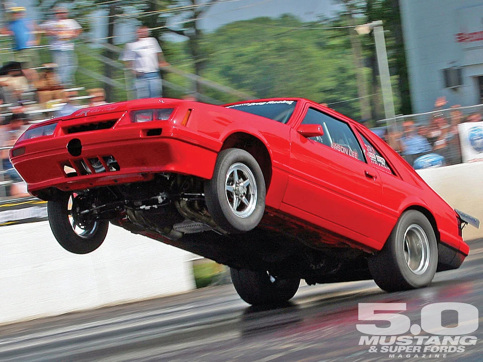

No, the left and right banks don't intersect at all. There is no crossover. It's basically the same as when you see racecars with "bullet" style mufflers connected directly to the headers. The difference is, my car is L O W so I needed to mount the mufflers in the factory location which necessitated the roughly 4-foot pipes between my headers and the mufflers.
Basically, just like this, but with a straight section of pipe between the headers and mufflers:
