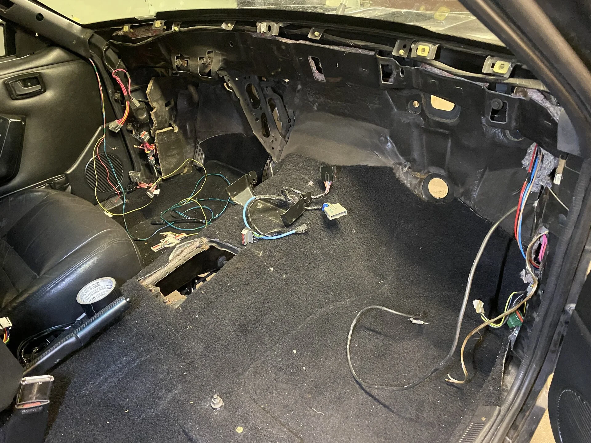

Everything is out that would have to be removed to do this......

I have to gut the rest of the car and clean it so its hard to tell if the firewall pad has any odor...

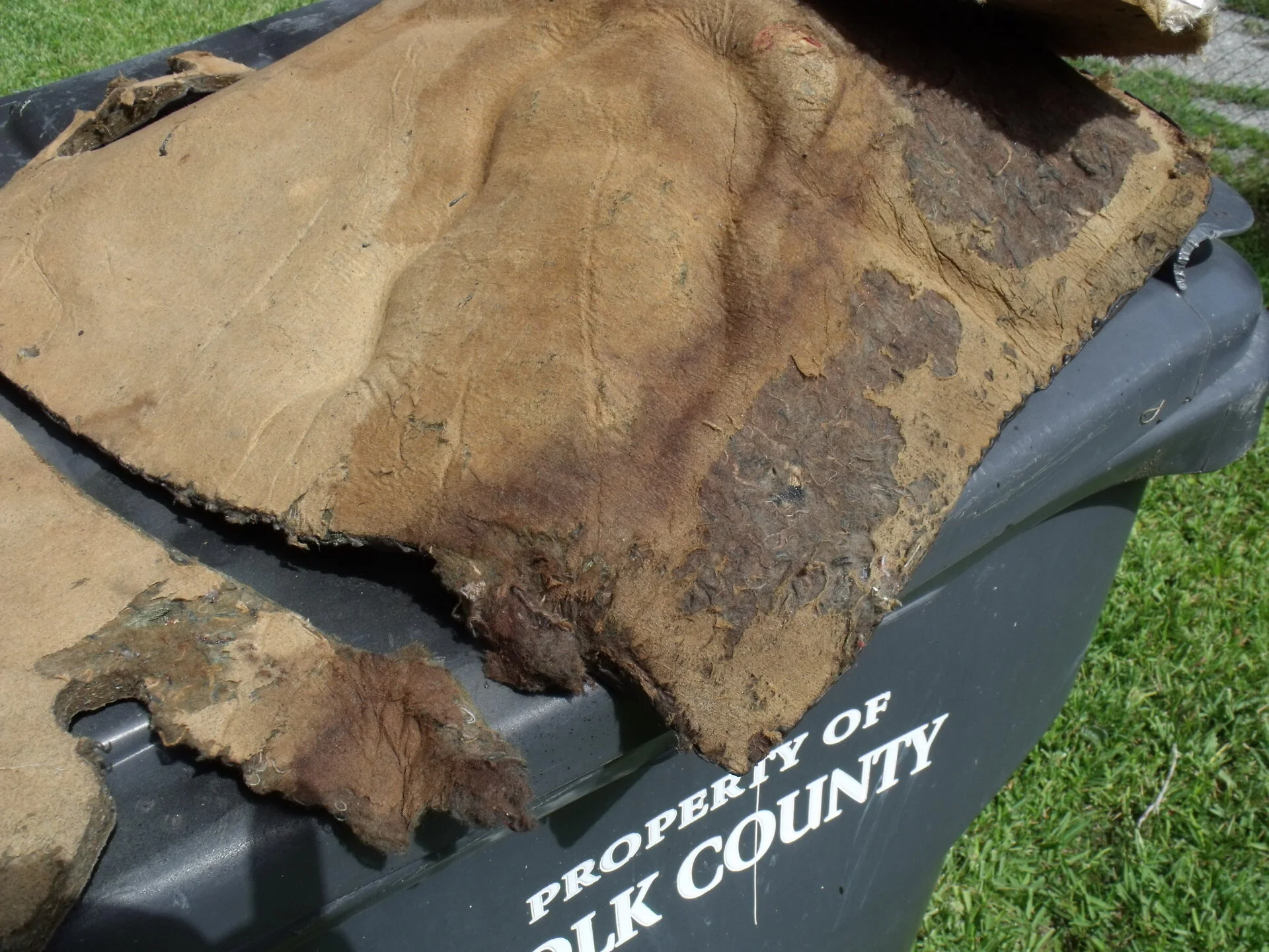

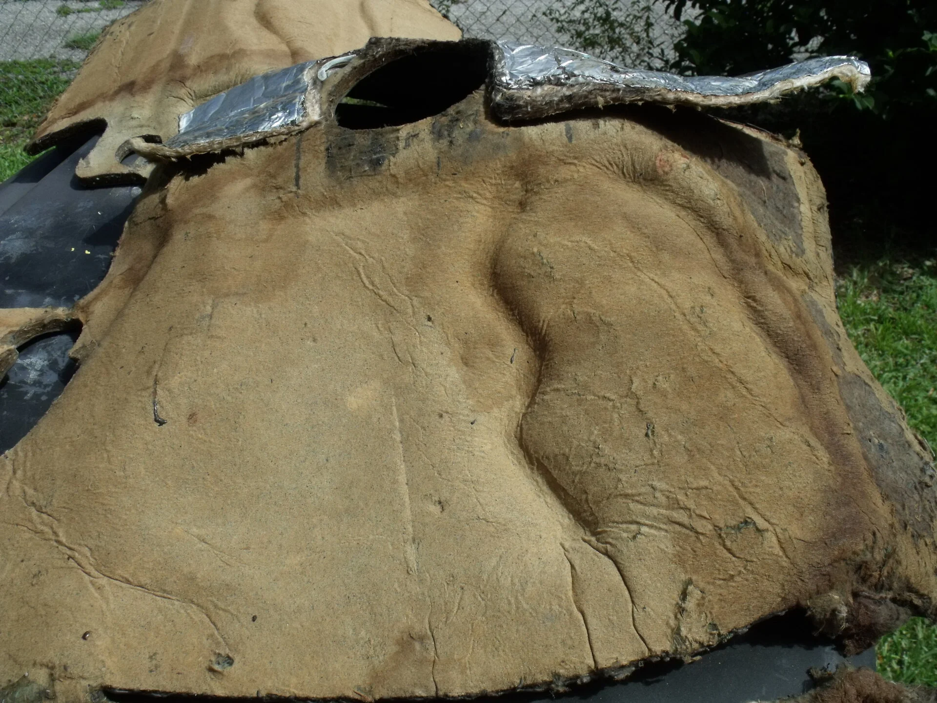

Some pics of the right side getting some sun..... You can see the stains, ( thats the lower part of of the insulation ) but it does not seem to smell.. I had concerns that it was Anti Freeze but the verdict is out until it sets in the sun a few days...... I have never had luck getting anti freeze to evaporate...
I " think " I will reuse it at this time but as I said, after it sets in the sun for a few days....

This is how you fix it, peel the old jute off, pressure wash the back side once you removed most of it then let dry in the sun . buy a couple yards of jute from a fabric or upholstery shop and cut fit. Probably less then 20 bucks in material, maybe 30 with glue lol.
