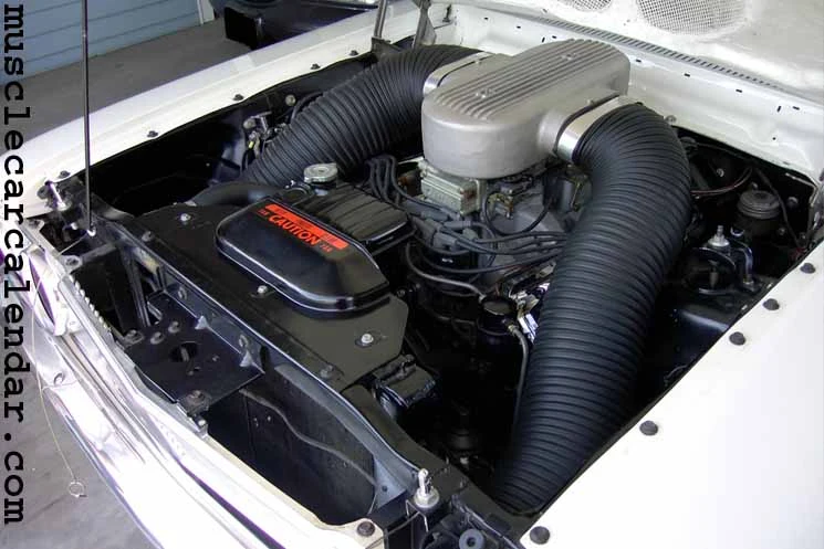

Ya know....it's not like this is the first time this idea has come about...one of the meanest Fords ever produced had a similar setup
:rolleyes: x infinity
Besides, if it doesn't work the worst thing i'll have to do is rip it out and put my other breather back on..
GTOReturns said:
Well thats different! I thought we were talking about a 5.0 not a dual snorkel T-Bolt!! Good luck!!
:SNSign:
Oh we are talking 5.0! I'm just a crazy SOB and i'm gonna make it work! :lol: Hell i figure my car came stock with a duel snorkel breather with inner fender ducts, so taking that further down to the nose shouldn't be a big deal. If nothing else i'll end up with a dirty air filter...also my car only sees rain when i get caught in it, and the water would have to travel UP the tube, which i don't think is going to happen even at driving speeds.
