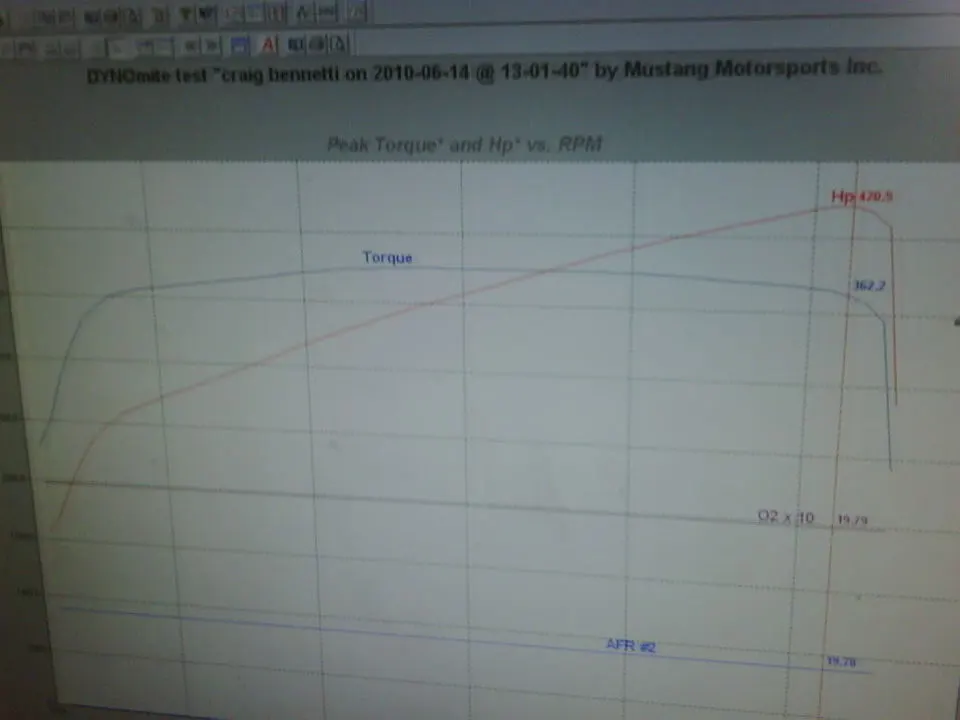

07 GT Auto on a load bearing dyno:
the vid:
Craig B Dyno Pull video by sraldiris - Photobucket
Look at those power numbers, curves are nice and smooth and the AF line is pin straight. That's a perfect tune! When you get bored with it later on you can have a dyno tune and make more power like Sharad says, I'd have some money on the side for a and FRPP short block though. :nice:
Actually, those numbers are abot tright for the Auto. I was looking at the Livernois site and the rwhp numbers are more significantly less for the auto than manual than I remembered. Thx again for the feedback fellas.
