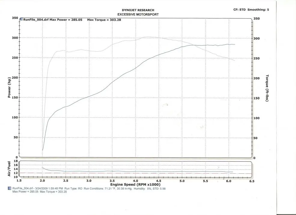

I had a Brentspeed 93 octane tune. It was ok. I went to a dyno pull that the Mustang Club I belong to put together and my A/F ratio was in 14s. So high that they would not pull it the third time. I asked Brentspeed for a revised tune and that brought it down to the mid 13s. No problem with their customer service. But every engine is different, and what might be perfect for one engine might be off on another. I just had it dyno turned at a local shop here and the A/F is right on and while the HP didn't increase, the Torque went up by 14.
I don't know if a shop can just "tweak" someone else's tune, but definitely do it.
tune the car on the dyno that way you know everything is right and accurate...the preprogramed tunes are just for average cars and in most cases will work fine and you will porlly notice som e power gain but it wont be the max power....so go for the retune
