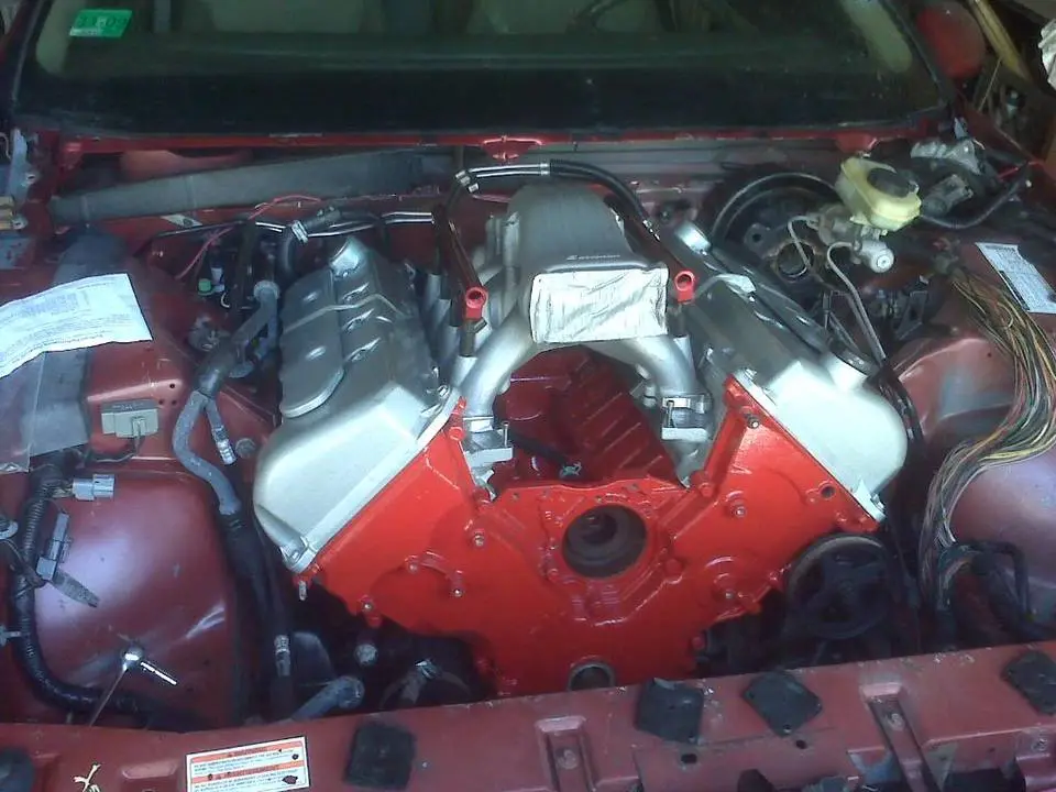

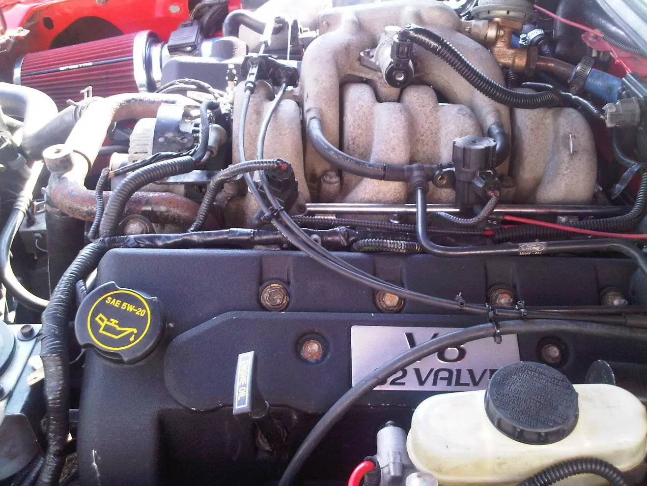

anyone seen this intake manifold?
Looks like someone took the stock intake off and threw that on to sell stock intake for more money. That thing looks bad. I've never seen an intake look like that that goes on a mustang.
Early Lincoln Mark VIII or Continental.
If thats the case, why would someone through on an old ass intake manifold?? Wow. Honestly I hope the previous owner didn't switch anything else out. To the op I'd buy the stock cobra intake asap.

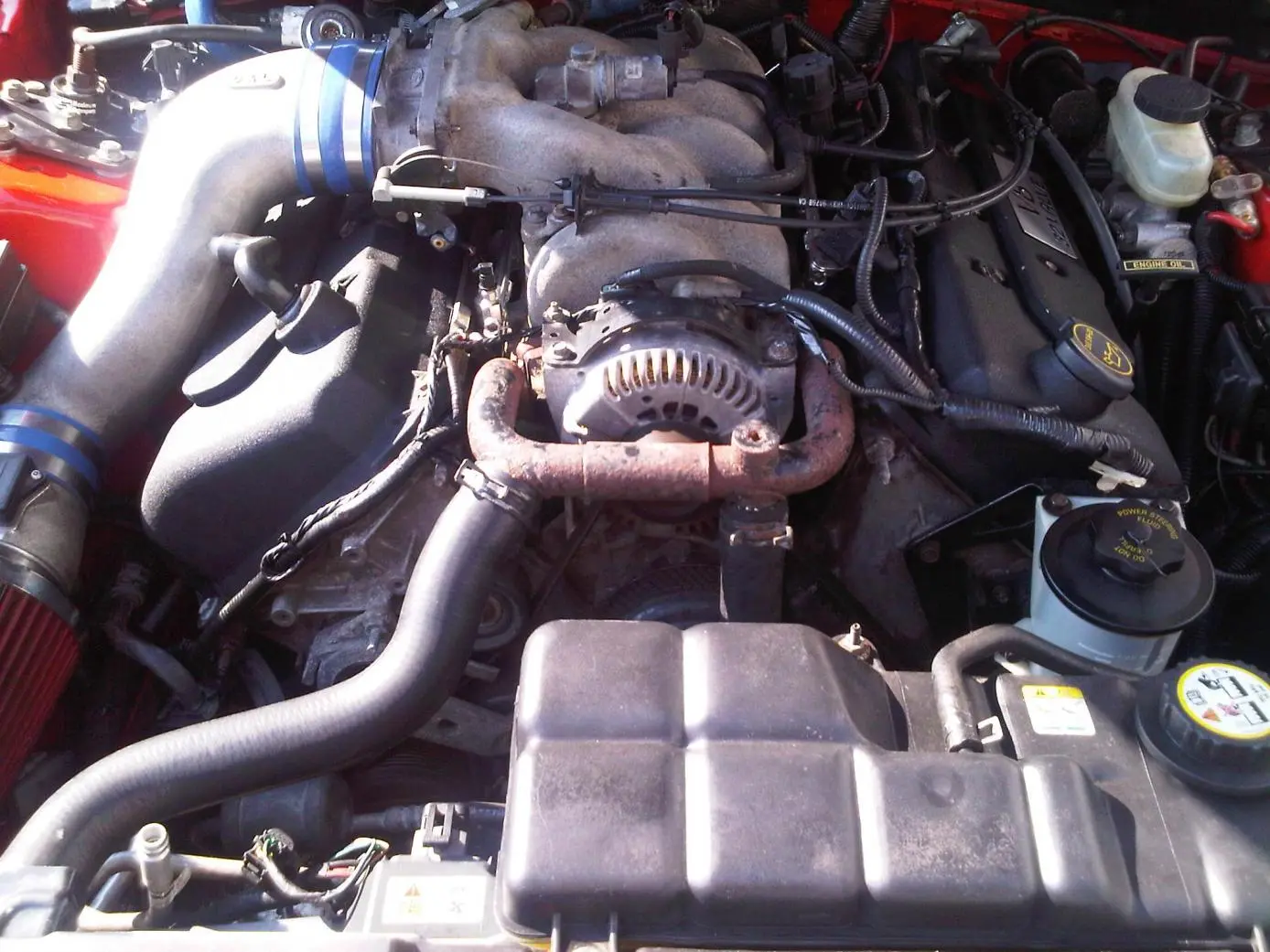

Hopefully it's just the intake that was swapped. What if the cobra engine was swapped for a Lincoln engine... OP. Post some more photos so people can get a good look at the car and engine bay.
Those valve covers look strange too! Post more pics... I'm curious now..
Early Lincoln Mark VIII or Continental. Kinda strange they would swap that intake on an 01 Cobra, I would do some checking and make sure that the hole motor isn't from a Lincoln.
After reading this post, I took a closer look at the pics.....that is NOT an 01 Cobra engine. The va;ve covers (among other things) are not from a Cobra motor.
In my opinion, the previous owner blew the motor and went the cheapest route to replace it.....an underpowered Mercury sedan motor.

That looks like a 97 mark VIII engine. I think the 96-97 marks came with coil over plugs and black valve covers just like that. Sorry looks like you have b heads on your hands. That engine is very under powered as well, 285hp.:notnice:

The only Mercury that came with a 4v of any kind that I knew of was the 03-04 Maurader. Also it came with 302 hp and 318 ftlbs, so underpowered compared to the 01 Cobras 320 hp but not a weak engine. The intake is not off the Maurader its intake and engine looked like this.
It was common in many Lincolns however which would be a possible swap. There were different years for it so the numbers could be as low as 260hp/265tor or 290/295 :shrug:

that is not an 01 cobra engine. Who would remove hot looking valve covers for plane Jane valve covers, here is an 01 cobra engine. I'd tell the seller to take the car back for being totally deceitful and a crook. I hope you have his information and that hes the one on the title when you bought it.
Honestly after looking at your engine pics, how could there be rust on the coolant lines?? That engine looks like it was in katrina or some sort of flood.
The tentioner is also in a different location!

First off Its a LINCOLN MARK 8 Motor.
Nothing wrong with the Lincoln Mark motors....The block is aluminum 32v heads. Those lincolns were advertized at 300hp stock. Stock pistons and rods are blah. Each intake port on the head has a secondary port thats controlled by a unit on the back of the motor.
Want alot of power from that motor....Swap the 4 cams and port the exhaust side.
Only problem is to make those heads work right you need the lincoln computer and harness.
But on the bright side....a 32v 5.4 would be practically a drop in at this point seeing how they use the same valve covers and share alot of parts.
Heres a car that had that engine in it....I removed in and replaced it with a 5.4

Technically it is a "Cobra" engine. The intake looks like that because the intake runners are very long and twist down into the valley. Now i would be pissed if i was supposed to get a terminator (5.4). But theres nothing really wrong with the lincoln motor. If you really want to then toss some C heads on there from ebay and get a cobra intake.
And plus you got the stronger Aluminum Teksid block!!!!
If that guy put aftermarket headers and exhaust on it then the car should be making around that 320hp that you want. The lincolns only made 300hp because the lincoln exhaust was designed so you could hear rats pissing on cotton at idle.
