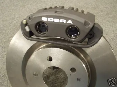

I bought the black cobra calipers and 13" brembo rotors but they didnt come with banjo bolts. Does anyone know what size I need? I have been told my 2000 GT has the FINE thread banjo bolt and the new calipers will, too so I can reuse them... But Im getting ready to order some SS lines and need to know what Size to get because they come with new ones! PLEASE HELP!

well stangsuspension.com claimed I needed the course thread bolt so I ordered a set of MM ss lines w/ course banjo bolts. Hopefully it will go smooth!!!
It's a fine thread pitch. 1.0 vs 1.5 I think. I don't remember exactly. Discbrakesrus hooked me up with the right ones. Going from PBR to PBR you should be able to reuse the OEMs. I went from '97 GT fronts to Cobras and the bolts were NOT the same.
