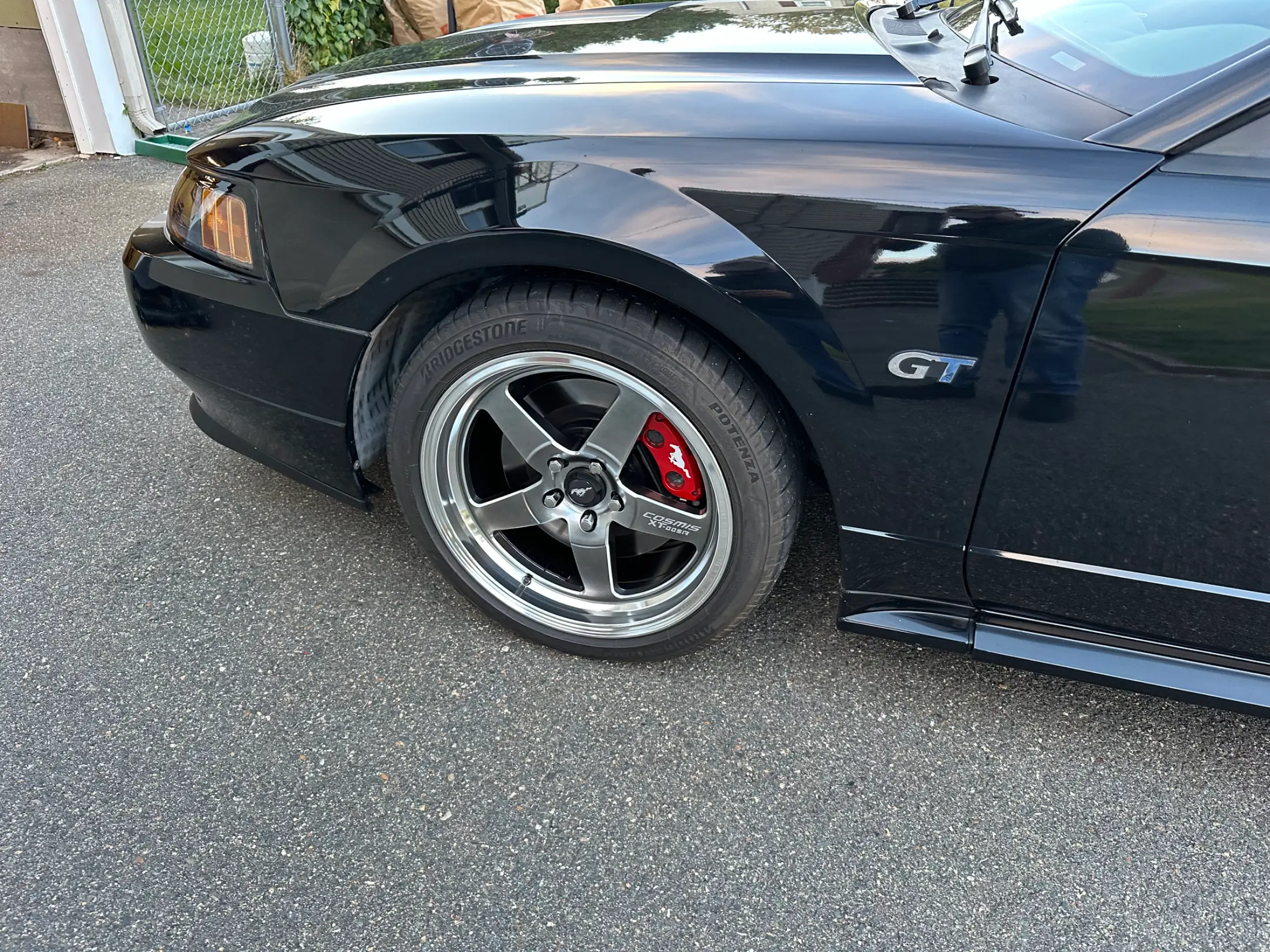

Heyy everyone, My dad has been working on my 2003 Mustang. We are looking for whatever is needed to convert the brakes to the 2003-04 Mustang Cobra brakes.. Sorry for the dumb question but we want to make sure we have everything to change it over so if anyone could tell us what all we need please let me know. Any help is greatly appreciated.

On a 2003 GT, all you need are a pair of 13” cobra rotors and a set of 99-04 loaded Cobra calipers complete with pads.
You do not need new soft brake lines. You can replace yours if they are old and you want fresh ones.
You do need specific banjo bolts for the cobra calipers. The GT ones are too long and hit the piston. Test fit then before starting as there is a coarse and fine version.
When you bleed the brakes, don’t forget to bleed the two bleeders on the master cylinder as well.
Make sure you have 17” wheels, and keep in mind your spare tire no longer fits the front.
Good luck. Its a fun mod
