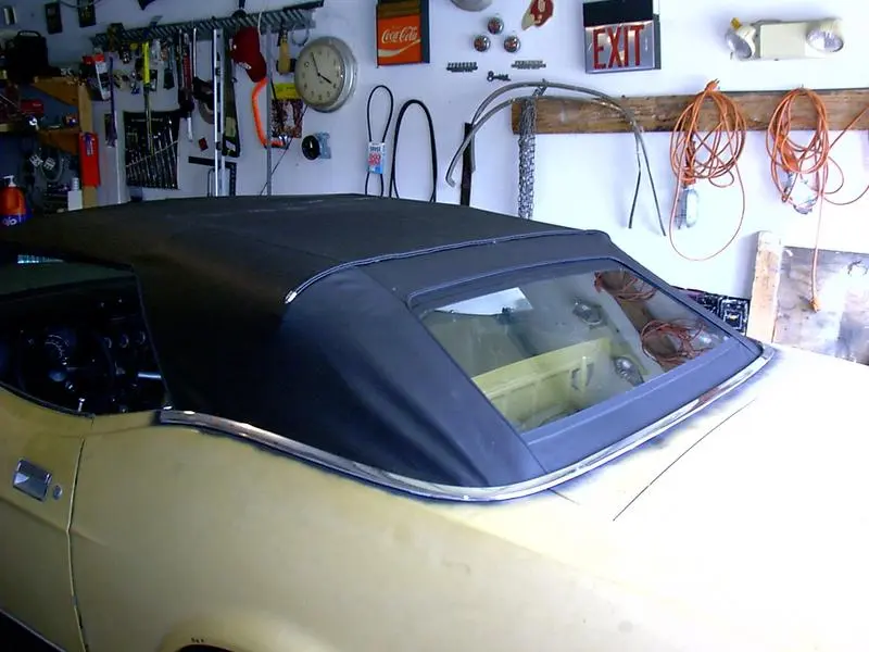

Yes, I did put my own top on my '72 model. No, it didn't turn out perfect. Here's the lessons I learned.
1. Buy a really good staple gun. Not a "stapler." A gun.
2. Pay attention to how the old top comes off. Check the lines that the manufacturer put on the new top CLOSELY. Don't have an old top to remove? Wow. I guess I would say MOCK IT UP BEFORE YOU STAPLE ANYTHING. I didn't check the lines closely enough, and the rear window is about an inch too low.
3. You CAN'T pull it too tight. Like someone else said, the sail panels are the hardest part. You can see it in the photo I attached.
Lots of guys would pull my top off and do it again. I decided to let it go until I wear it out for two reasons: My wife said "huh? what's wrong with it?" And I keep the car in the garage, and only drive it on top-down days anyway. (When and if I get a chance to drive it -- it's sat for about two years now.)
I'll do better next time.

It's a glass window. The old top that I stripped off had a plastic window; the zipper had rotted away and torn into several pieces.
When I compared the new window to the old one, I noticed that the line on the new window was in a different spot. At the time I thought to myself "looky there -- that last guy didn't know what he was doing."
I guess he showed me, because it was HIS window that was correctly marked.
