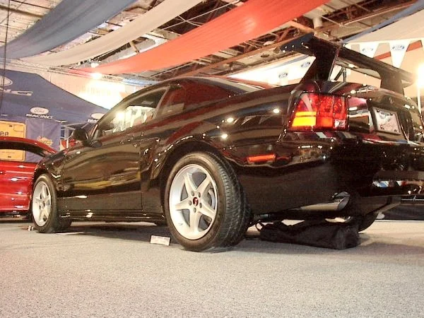

I use the H&R spacer on the rear and the MM 1/4" spacer on the front,....no problems.​
