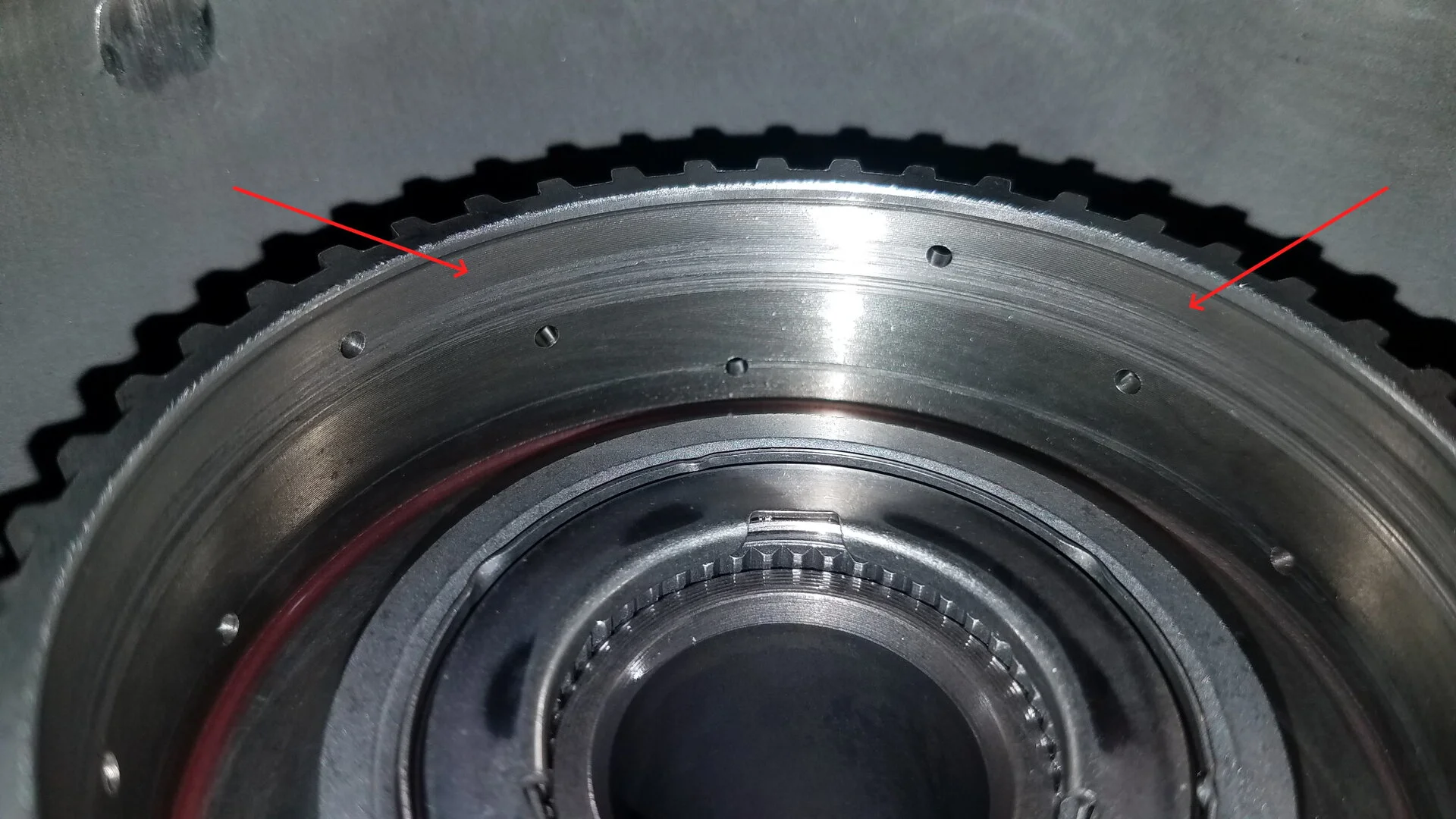

The only visible damage that i noticed was inside the forward hub here is the picture:

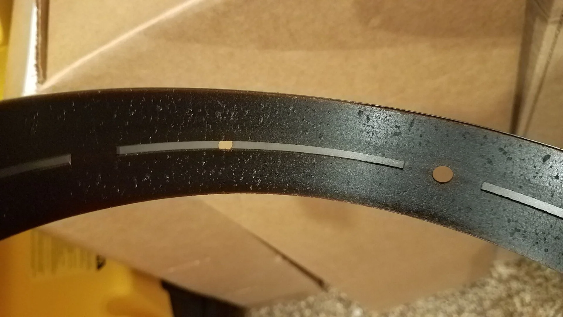

OD Band does not look happy too but i already have new one:
Transmission fluid was nice red, clean, no burnt smell, no metal flakes.
I ordered the bushing kit so i hope it will get here before holiday weekend. And ill order the clutches and seal kit. I have installed B&M "shift kit" 2 months ago.
I think vibrations that i get are due to worn bushing/s i think it might be the one inside the forward sun gear...looks a bit tired.

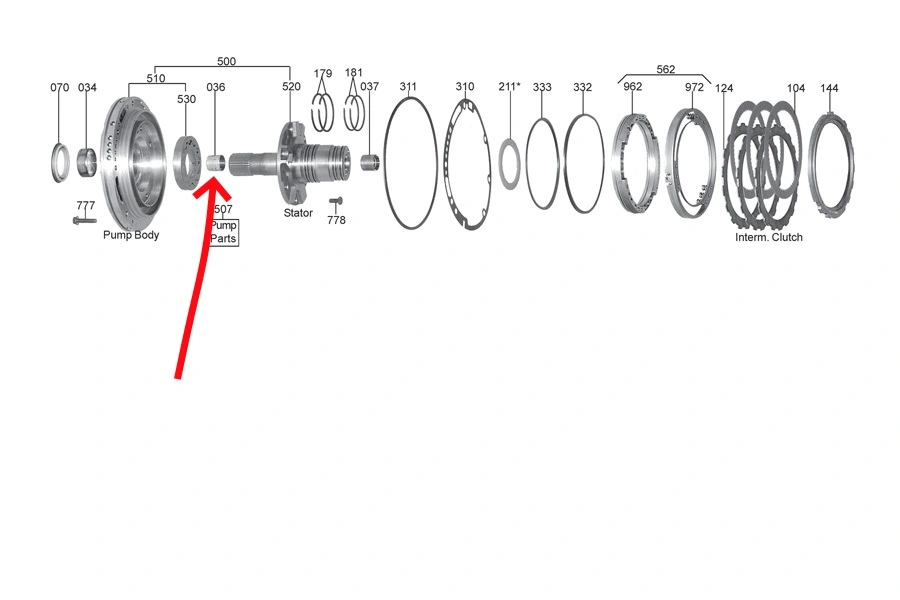

Does anyone knows if the AOD(89) stator has a front bushing 036?
Mine did not have front one, just the rear 037. So I was wondering if that was the problem with vibrations.

Yes it is supposed to have one. Yes that could be the source of your vibration. I would make sure all the bushings and bearings were there and in good shape before putting it back together and in. I wouldn't worry about the pistons or seals too much if it was shifting ok before.

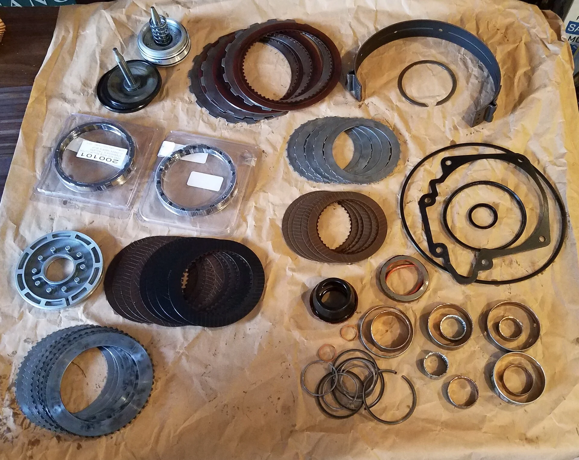

I'm getting close to be ready for some road test this weekend, transmission is back together.
Here is what was replaced(old parts)
I hope that will solve the vibrations issue.

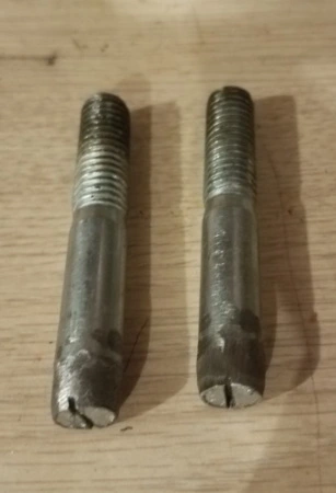

Here is how i make transmission installation "easy"
Those are guides to align transmission with engine. Just 2 bolts with slots for screwdriver(just in case when they get stuck). Also helps a lot with Torque converter/flexplate bolts. Screw them in on opposite sides slide the transmission, put the other bolts, remove the "guides" and put the proper bolts....and you are done

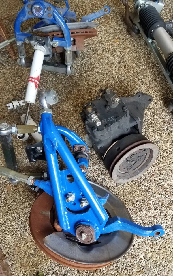

When I started to chase the solution for the vibrations I check the angles for the driveshaft, transmission and rear end. I used TREMEC application on my phone and it showed me that the angles were OK. Also i played with angles transmission(AOD) and multiple rear end shims(0.5,-4.5deg) no noticeable change, the vibrations were there.....There is another possibility and reason for the vibrations. Last evening I decided to pack the wheel bearings and here what I found:
View: https://www.youtube.com/watch?v=9CY5wclEi_s&feature=youtu.be
Those bumps are not grease, that's metal....it looks like someone tried to chew on that spindle(driver side).....I already planed to upgrade the front end so maybe that will fix the vibrations. The parts are already waiting for the swap(came from 65 mustang so it should be easy)
