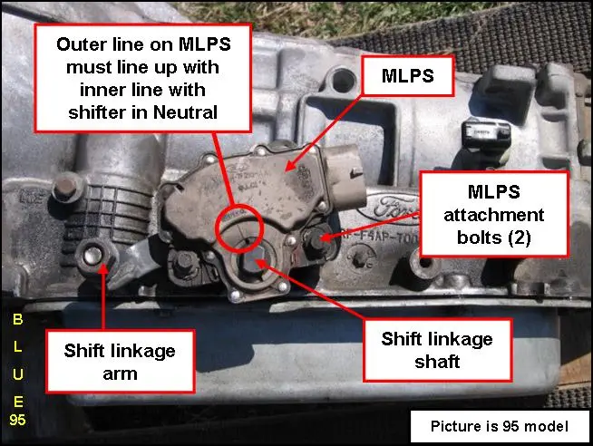

If the car in question is a 1997 Mustang (V6 or V8?) , it will not have a tv cable/kick down etc . It does not even have an aod. Unless it was swapped in there.
Should have a 4R70W- which uses a MLPS - manual lever position switch
