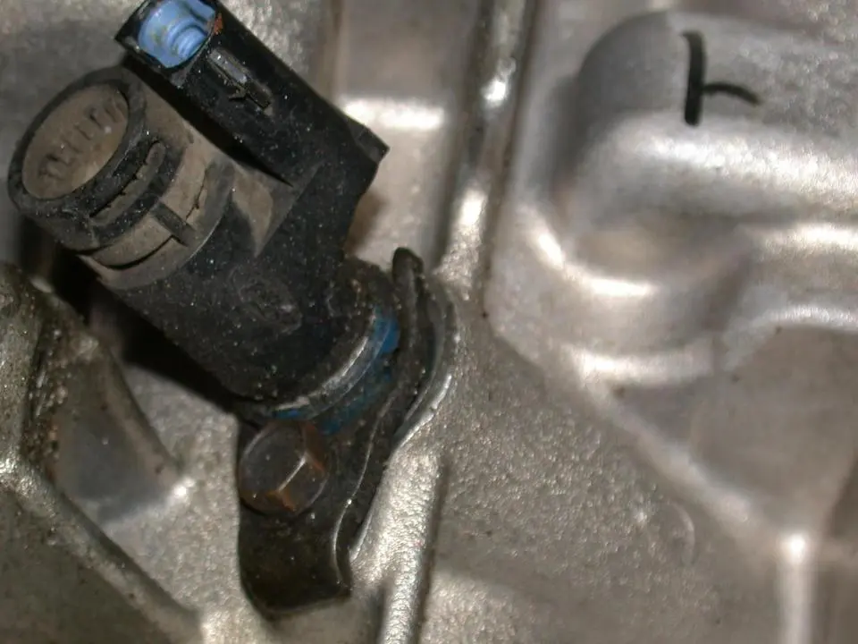

I'm in the middle of swapping my AODE to a T5. I have a transmission like one pictured below. What goes in the hole that is circled? Is it the speedo gear and sensor? Mine doesn't seem to fit [it's loose]. Any advice?

Yes; it's most certainly for the speedo sensor. There should be a retaining clip/bolt to hold it in there.
Like this:

I tried taking the one out of my AODE and putting it in, but it does not fit. I went to Auto Zone and the AODE and T5 have the same part # for the speed sensor. The speedo gear needs to be changed [different part number for AODE and T5] and considering I have 4.10's in the rear, I should change it anyway. I just ordered a speedo gear for a T5 and I'm hoping that's what was causing it not to fit correctly [due to using the AODE gear].

It is a speedometer sensor and with the AODE one you can cut about a 1/4 inch off the tip and it will fit in just fine.
