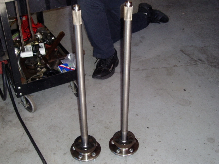

31 spline mosers. Been in for 2 years and about 50 launches.

I was leaning towards the Mosers before and I think that you guys sealed the deal. Did anyone have trouble getting the abs rings off the olf axels and onto the new ones? I have read that they sometimes break. Is there anywhere to get them other than the dealer and SHM?
