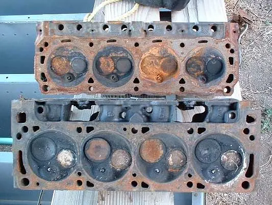

Do you mean the passages on the ends of the head like a 289 has and what do you mean c style
C style would mean canted valves. If you look at the valve springs it should be apparent that the valves aren't parallel to each other. To me that's the easiest way to tell a Cleveland style head from other small block Fords.

Case in point; Windsor on top, Cleveland on bottom:
The Cleveland head is not that much bigger than the W; the C head is just closer to the camera.
