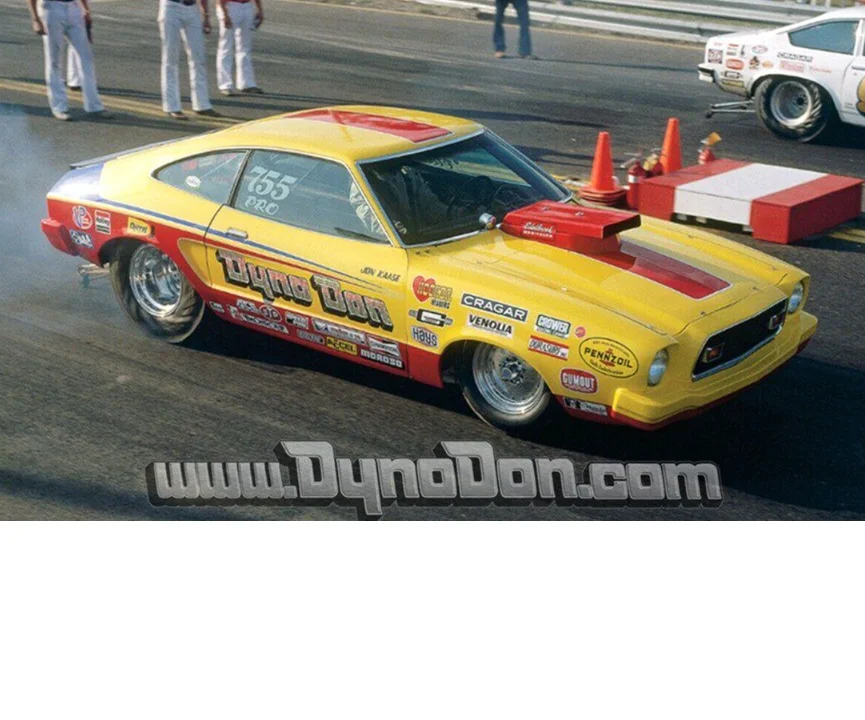

Maybe they would take something like this...
I don't what numbers they were making for horsepower, but it was called Pro Stock.

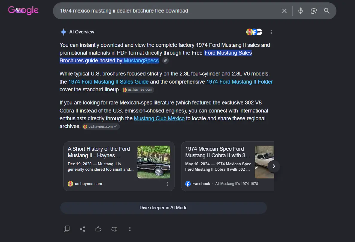

I don't know how much this helps you, but the Mexican version of the Mustang II used a 302 V-8 rated at 205 horsepower. 20 percent over that would get you to 246 HP.
  • Winner
  • Informative
Reactions: 2Blue2 and LILCBRA
I clicked the link and found literature, but none of it was Mexico only, it all appeared to be standard Ford USA. Maybe you can find some contact info and reach out, maybe they can help?
I had the same experience; I managed to find brochures listing 205 hp, but unfortunately, I haven't found a data sheet or vehicle document yet.
I’m finding bits and pieces little by little. ;-)
If anyone here has the Mexico registration details for their Mustang II, I would really appreciate a picture of the vehicle document.
