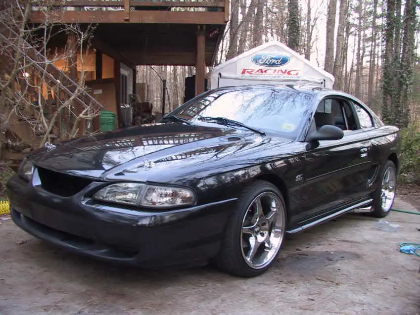

Sneak preview... I wasn't gonna let anyone see it till it was done, but oh well Rears are still stock, they're going in tomorrow. Still got more to do on the car, should post finished pix next week

nice side exhaust, looks rowdy.

Thanks! It sounds awesome too Just short of open headers....
