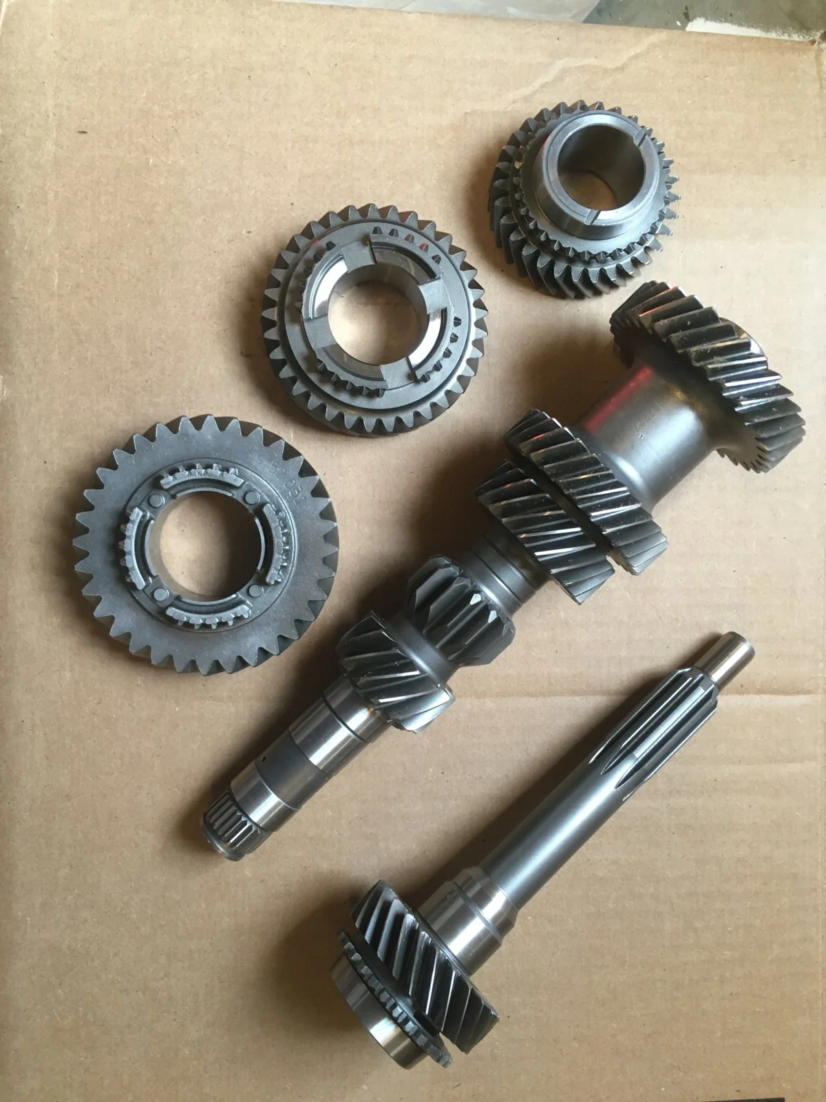

I have the hard to get 2.95 1st gear cog in hand. Now waiting on the input, cluster, 2nd and 3rd which are on the way from Astro.
My current T5 is in perfect working order so when I tear it down I plan to reuse anything that is worthy. Trying to keep this experiment cost as low as possible.
In your opinion, other than the gears I'm changing out, what else would you consider "mandatory" to be replaced?

Alright, I got the Z-spec gear set now. Total of $425 including shipping across two vendors.
