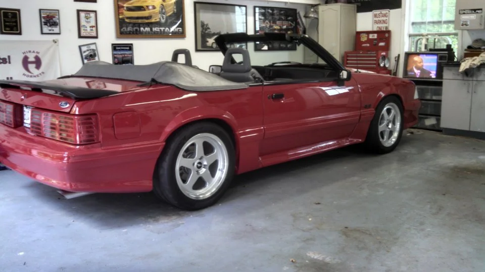

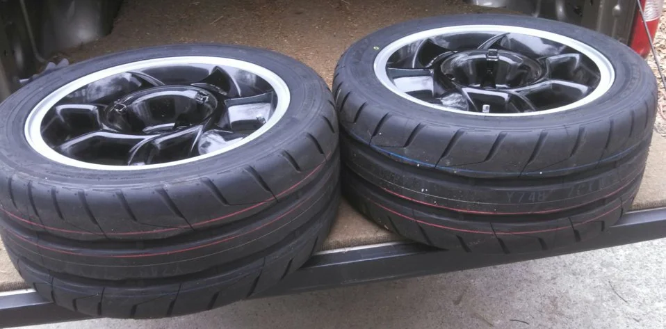

The tires are Nitto NT05 drag radials in 275/40-17's. I no longer have the wheels. They were the black '93 Cobra replica's in 8.5"x 17" from LMR.
Now the drag radials are mounted on these 17x 9" Stern replica's.
