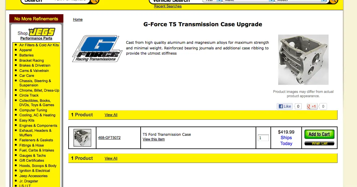

G-force makes an aftermarket case for the T-5. An upgraded cluster support is offered by Astro and maybe G-force too?
If you are thinking of an upgraded T-5 call Tony at Astro. Tell him what you are doing and he will recommend a transmission to fit your needs. I doubt he would push any T-5 if he thought it was boarder line strength wise. Last thing Astro wants is a broken trans.
