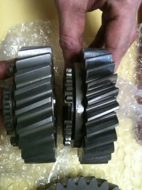

I think if your hp/tq is in the range of the Astro A-5 you should at least consider it.
The Astro gear is on the left.
Wow, I never knew the Astro 3rd gear was that much wider than the g-force 3rd gear.
Why would anyone use a G-force over Astro?
I'm sure that, that upgrade alone is a vast improvement but it doesn't do anything about the shaft defection in the case.
