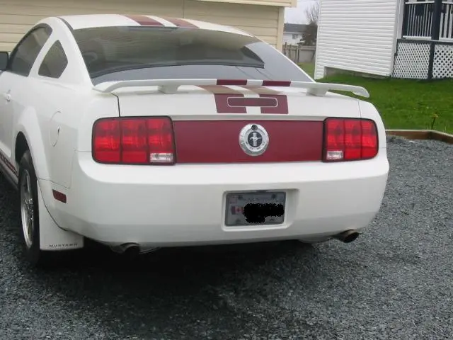

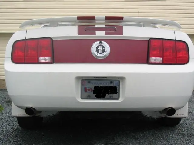

Ok guys I went with the Reverse Y set up for my duels. I left the front Y pipe completely stock, added a reverse Y behind it and now love the new sound and I have a nice kick in power all the way through mid to upper powerband, while the lower end seems to be the same. I cut my own bumper using a template I made of the passenger side, then transfered it over to the drivers side and used a dremal tool to make the cut in the bumper. Thanks for your imputs.
looks great! you did a great job with the dremal! :nice:
