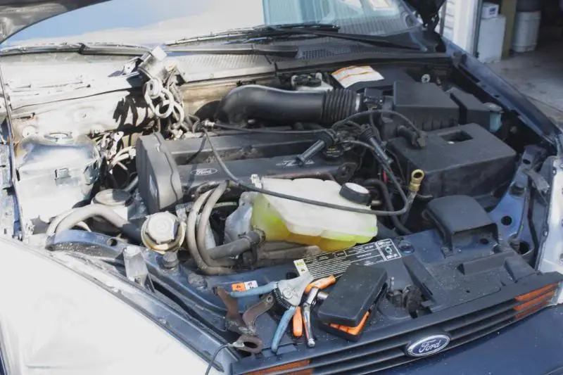

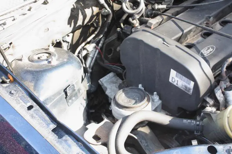

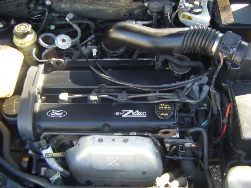

If you have ever seen under the hood of a focus you know the alternator is in the worst possible place to get to... Wedged under about everything (PS resiveour, coolant tank, fuel rails, EVAP, and many brackets)
Pics from when i did this on the G/F's focus like 2 years ago
and next to the frame rail. The motor needs to be jacked up and the alt needs to be pryed out... Well long story short... a little over an hour in the dark and i had it out. Unlike the mustang where im scared to scratch my engine bay i hammered brackets out of the way and after about 20 minutes of prying and pulling i got the alt out.
