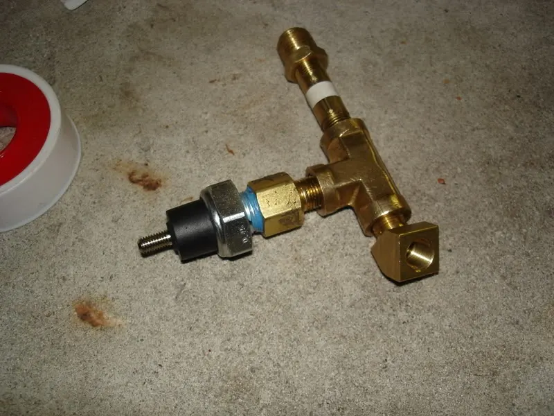

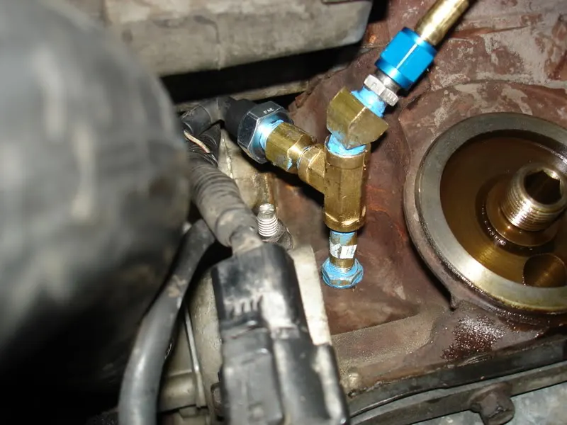

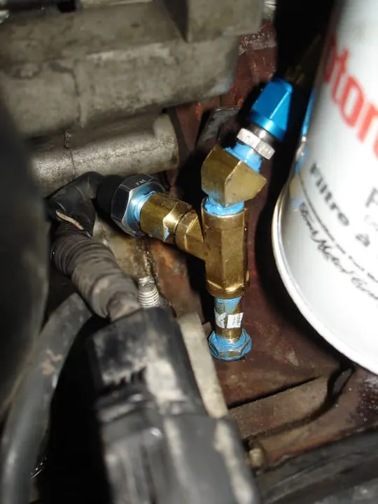

Heres what I did.
I use a mechanical oil pressure guage in the dash, ran a 6 ft braided line to it and bought some 1/8" fittings from Ace hardware.
With my setup it I can get an accuarate reading and my stock needle isn't dead.
