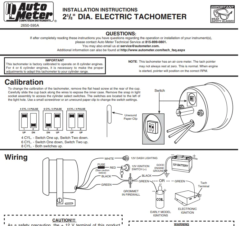

You have instructions for the tach?
Yes I do and that all looks pretty easy but do I cut a wire on the back of the fuse panel? This is what im asking.
No, unless your good at soldering and I don't like cutting factory wiring anyway, if you probe around the fuse box I believe there is a place with no fuse that is 12v ignition on and you can use a spade connector with the inline fuse.
