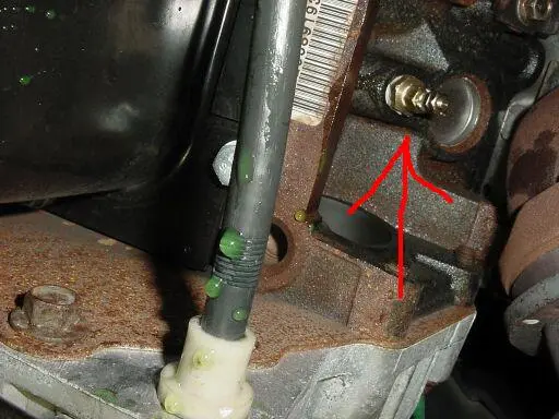

The plug in the block is the best place to put it. It is on the drivers side, just in front of the tranny, right above the clutch cable.
No tapping required. The fitting you need comes with the guage.

Is this location too close to the exhaust? I have the FRPP temp gauge and it is plastic unlike the others that are copper with a wire wrapped around it like a spring. I assume the Ford gauge has a copper pipe as well under the plastic.
I am worried mine will melt. Thanks

i torqued down on that damn bolt so hard i thought my wrench was gonna brake
edit: also the fitting was an 8mm allen wrench socket that i used with my socket wrench

dang i wish i new there was a plug there!!!i did the t thing,

i think the t fitting is goin to be easier. That damn plug wont come out and im afraid im gonna strip it. First thing tomorrow im gettin another t for it

i tried to get that damn plug out but i had no luck
