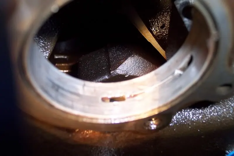

I just picked up a 5.0 project and decided to tear down the engine. I noticed the front cam bearing to have a couple nicks or so in it. However, the nicks have been worn down so they are not fresh.
The person who had it before me put a new cam in it so I don't have any evidence from the previous cam. When this cam was installed, it spun freely and didn't feel any grinding nor did I see any evidence on the cam journal itself. I can't really get a good look at the other bearings so I couldn't see if its like this throughout. Is this a typical problem people have when installing another cam? Should I be concerned to the point of replacing them? I do have the engine out. Here are the best pictures I could get.

yes but...the brass you see on the bottom of the bearing is because the bearing is worn. dont be a cheap ass!!! most shops install cam bearings for $40 and the bearings are $20=$60 to do it the right way! if the motor is coming out and the bottom end is coming apart then put some in it.
if its just a cam swap and the motor is in the car then dont worry about it.

if u put rod and main bearings in it i would put cam bearings in it.
will the motor blow if you dont...i doubt it. oil pressure will run a little bit lower.
whats it used for? if it aint gota go a million miles then just let it ride...
if you tell a machine shop to just do cam bearings ,thats what the'll do.100$ total for bearings and install now or hundreds later to rebuild.i just makes more sence to do it right.
