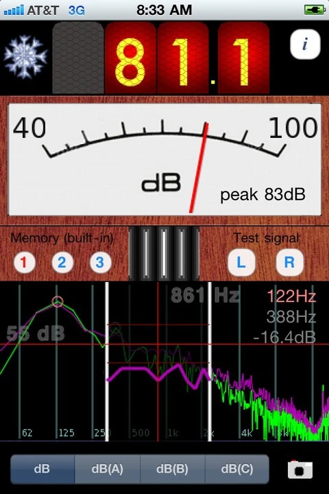

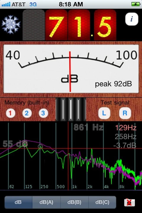

Decible readings before and after putting 1/4 wave tubes on my G8 GT, and the only reason I don't have them on my Mustang is I have no room for them with a catted H-pipe, torque arm, and panhard bar. 1o dB difference means it's half as loud now as it was before in the drone zone, which no longer exists on this car.
