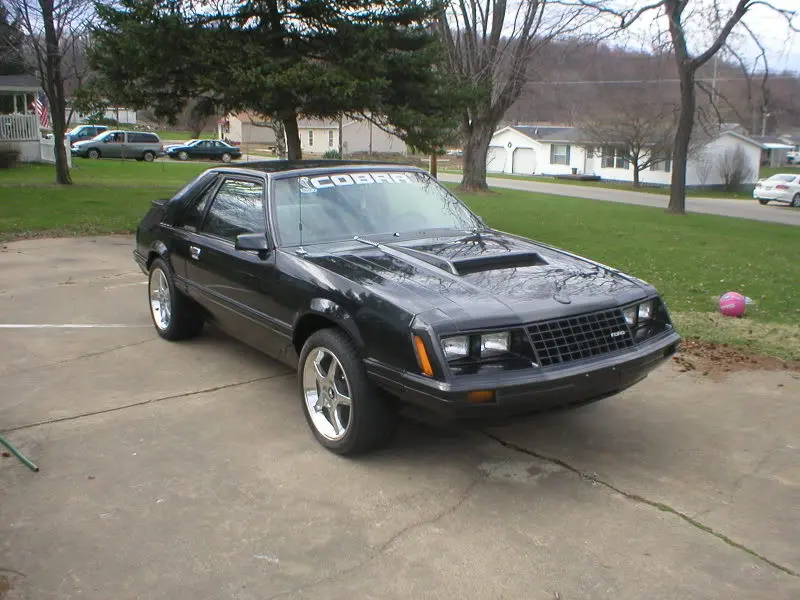

I have a 95 ranger with 18x9 chrome bullits with 235/40s. Can i swap axles and front rotors from the truck to 90 lx . I had to get 1 inch spacers to make the wheels fit the ranger cuz of the dust cap & center cap. I like the deep dish look & wanted to get the 17x10 sc wheels on the rear but im not beatin in my rear inner quarters to make them fit. Maybe a bigger tire if they fit 235 a little small for stang i think.
