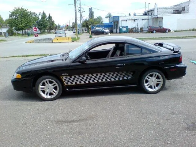

the 10th digit is a W but the car had apparently came with a paint job i have never seen before right from the factory. maybe the car is unique i have never seen another one that is painted that way the car currently sits on 2000 5 star rims,and has 1999 35th anniversary edition seats that i got for a bargain.

what's the EXT PNT code??

Vin: 1FAFP42X6WF******
Date: 08/97
Type: PC/VT
RC: B7
BRK: 1
INT TR: 7J
TP/PS:
R: 9
AXLE: ME
TR: 6
SPR: JHEE
DSO:
EXT PNT: UA
That is pretty much all the door sill says
cjones
Jul 20, 2002
1,561
37
Avondale, AZ
May 27, 2009
#13
  • May 27, 2009
  • #13
Date: 08/97
Type: PC/VT -
RC: B7 - region code - Pacific
BRK: 1 - 4 wheel disc
INT TR: 7J - cloth, Nomad sport seats, ebony
TP/PS: - for pinstripping/tape stripping
R: 9 - radio mid-line AM/FM, cassette, clock, premium sound
AXLE: ME
TR: 6 - tranny T45OD
SPR: JHEE - springs front part# 5310 rear 5560
DSO: - domestic special order
EXT PNT: UA - Ebony C/C

i had most of the information already just the axle code was throwing me off as is the paint scheme as even the dealer where it was originally purchased says that is the way it was delivered

figured but i was hoping that it showed a special order. you might run the VIN and see.
i'll ask my buddy tomorrow about the checker flag scheme. see if he's heard of it. he's been with ford for a long time.
