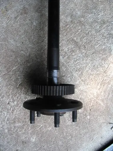

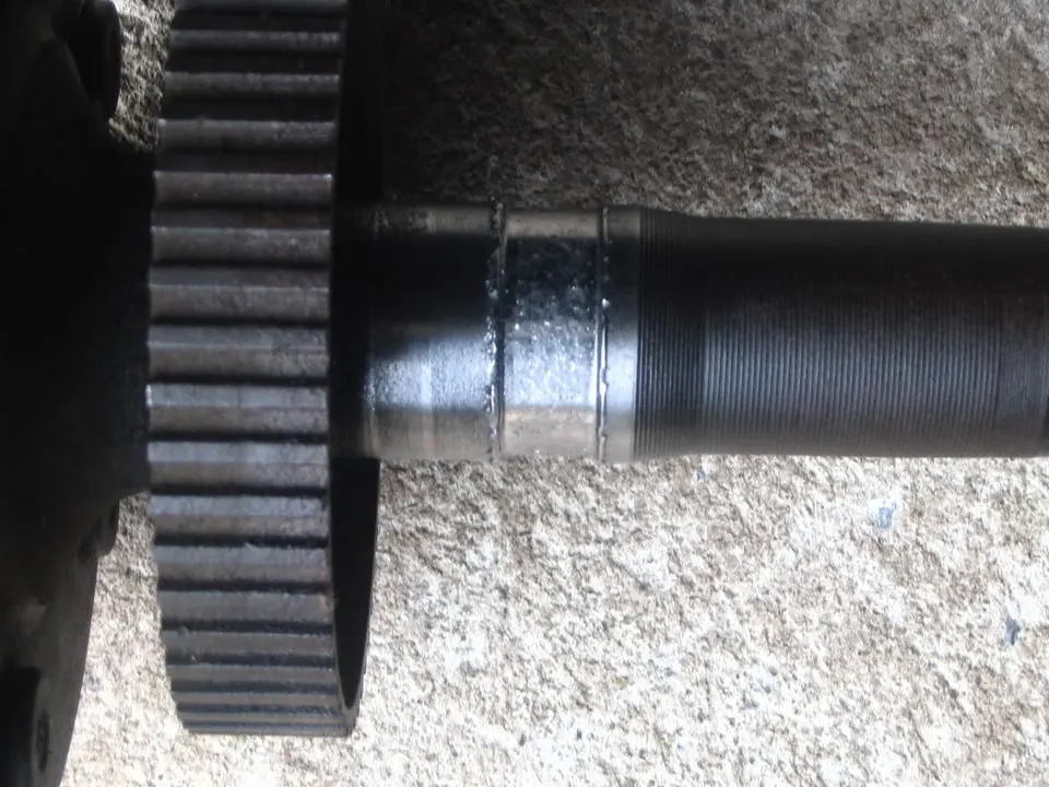

I need to replace 1 axle in my 96 GT. The car has 120 miles on it, but mileage was not the cause of the bent axle. The original one was snapped in an accident, the current one was bought used from a "reliable" source and it's not straight, so I'm purchasing a new one(s). I'm staying with the stock 28 spline. A few quick questions for you guys:

Anyway, to answer your question, unless you're buying Strange, you can expect to spend about $250 for the pair of axles (some companies like Superior include lugs, bearings and seals with that price in their Evolution Series line) I would recommend changing all seals and bearings if you're going to install axles, as I am fairly certain that I caused this bearing to cease by not swapping it out when I replaced the last axle with a used one.
Speaking of used axles............if you can get one from a reliable source, I see no problem with saving yourself a few extra bucks. However, I will say this.......... put new bearings in so they mate with the axle or you run the risk of having problems similar to mine. (NO FUN) Also, when buying used, it's buyer beware. You might be spending a quarter to save a nickel when you find out that the used axle you purchased is out of round or doesn't seal because it's slightly corroded, or breaks because it has hard miles on it. Just some things to think about.
Here's some photos of the damaged axle

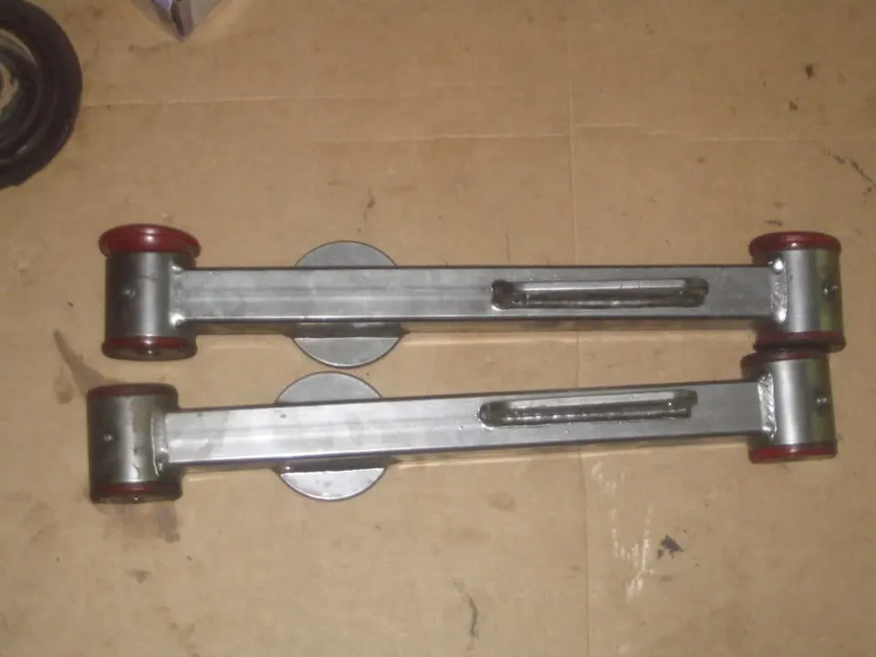

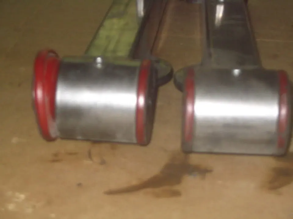

And some of my BBK LCA's that bound up, in case any of you are thinking of getting serious about suspension. (Hint Hint, buy Maximum Motorsport extra duty arms with spherical bearings :nice: )

Gearbanger 101 said:
Hmmm, those bushings look pretty dry to me. Are you sure you were greasing them often enough? If not, that would definitely be reason enough to make them bind up on you. :scratch:
I cleaned them off so that you could see them. They were on the car exactly 2 months, filled with grease through the zirk fittings till it came out the bushings. :nonono:
