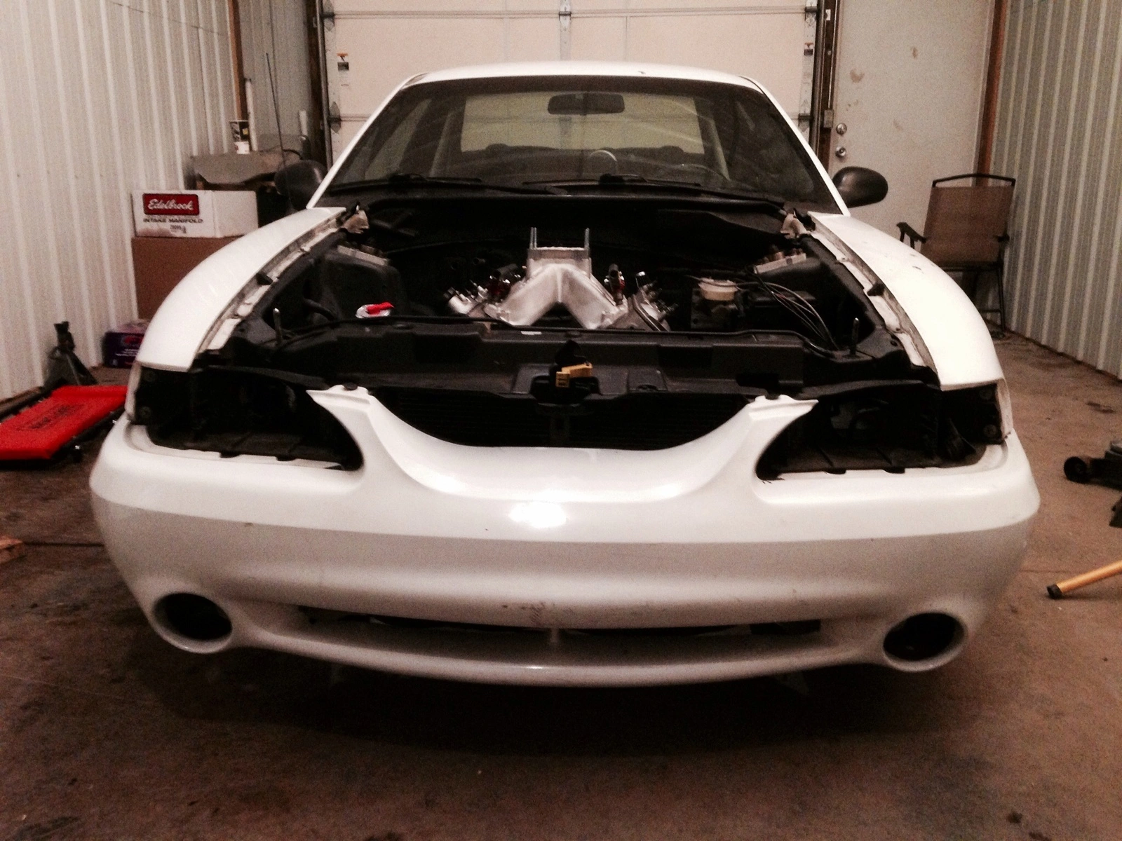

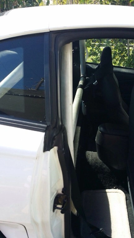

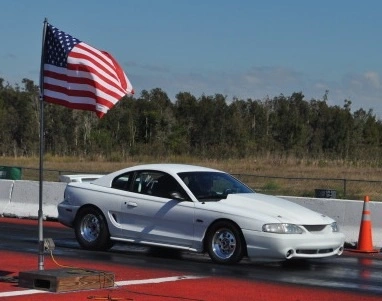

It's a 98 GT with cobra bumpers and a R hood. Full suspension, built rear, full interior (minus the back seat), with a 6pt. Various odds and ends from when it was a turbo 5.4 car.
I'm beyond excited for it to arrive and to have yet another mustang.

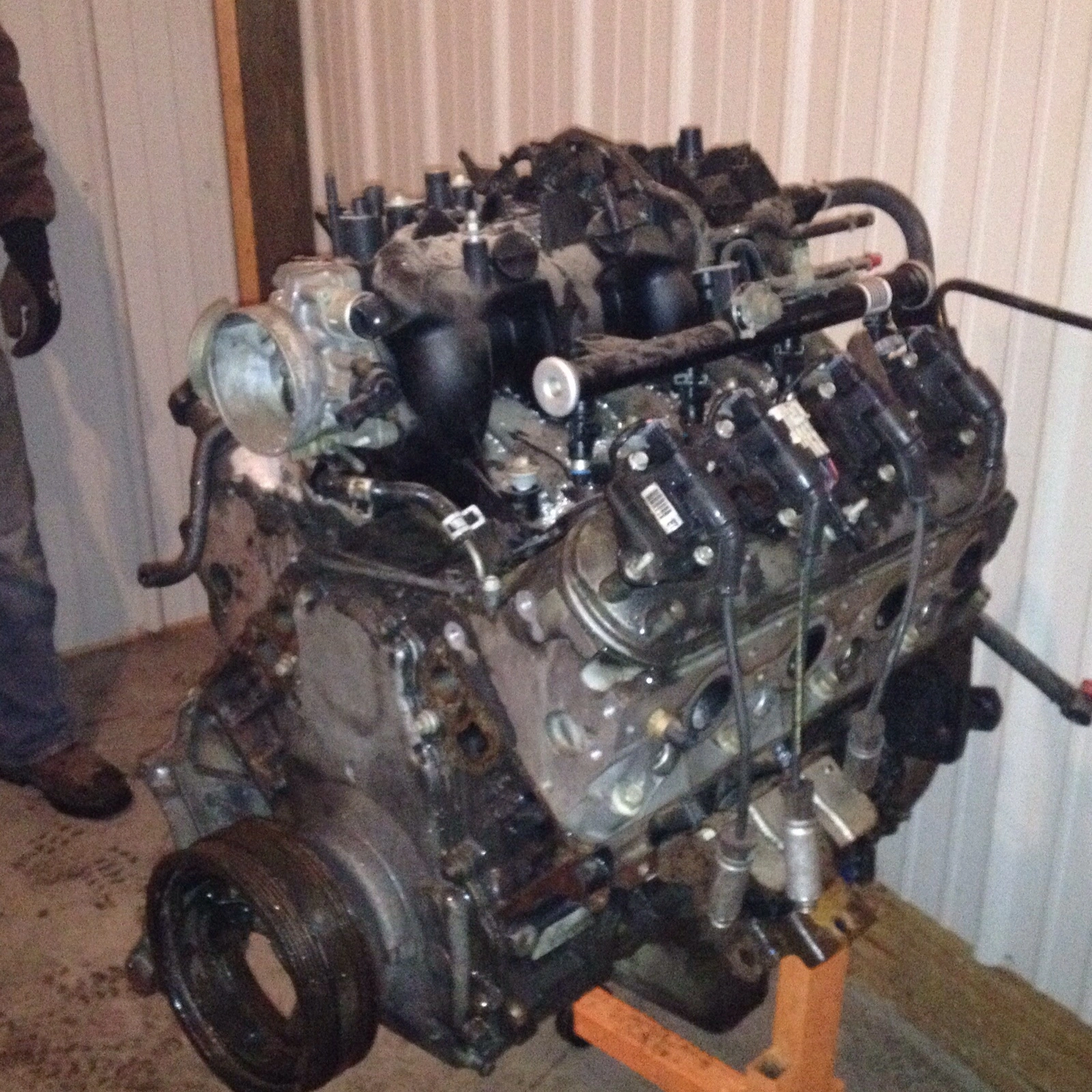

I see you have a truck engine, which one? I have an LQ4. I should be digging my thread up soon and getting it rolling again. Had a pause to do some more house remodeling.
Reactions: tannerc91gt
This is an LM7. I like the 6.0's a lot but for my plans a 5.3 is gonna work just fine.

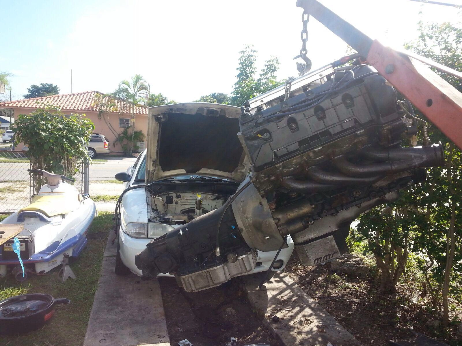

It just got it's turbo 5.4/400 pulled out yesterday.

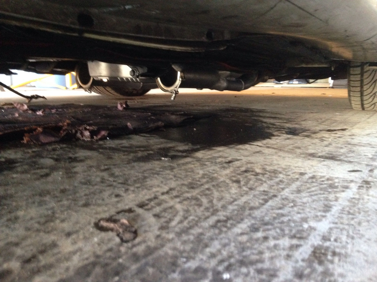

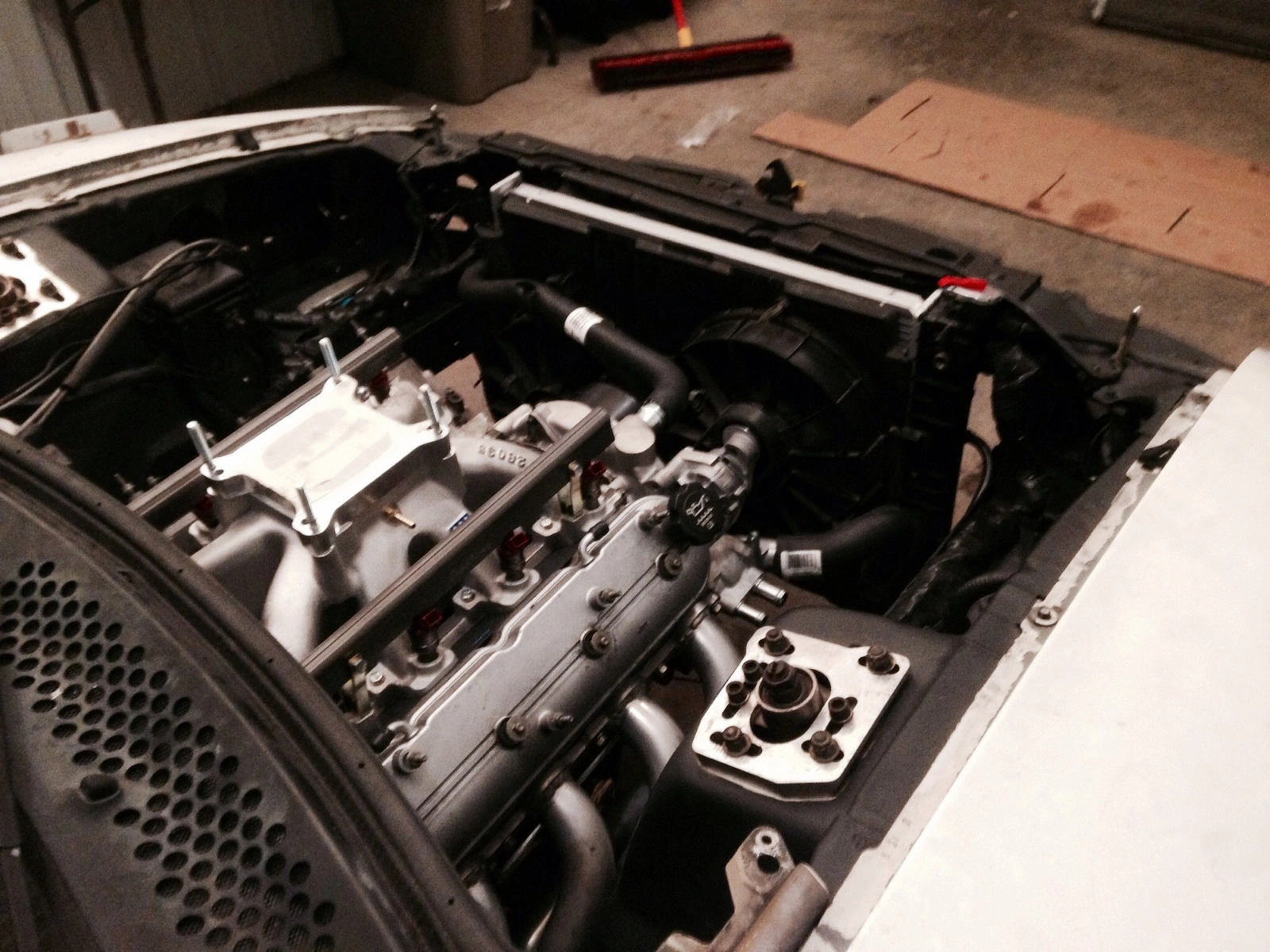

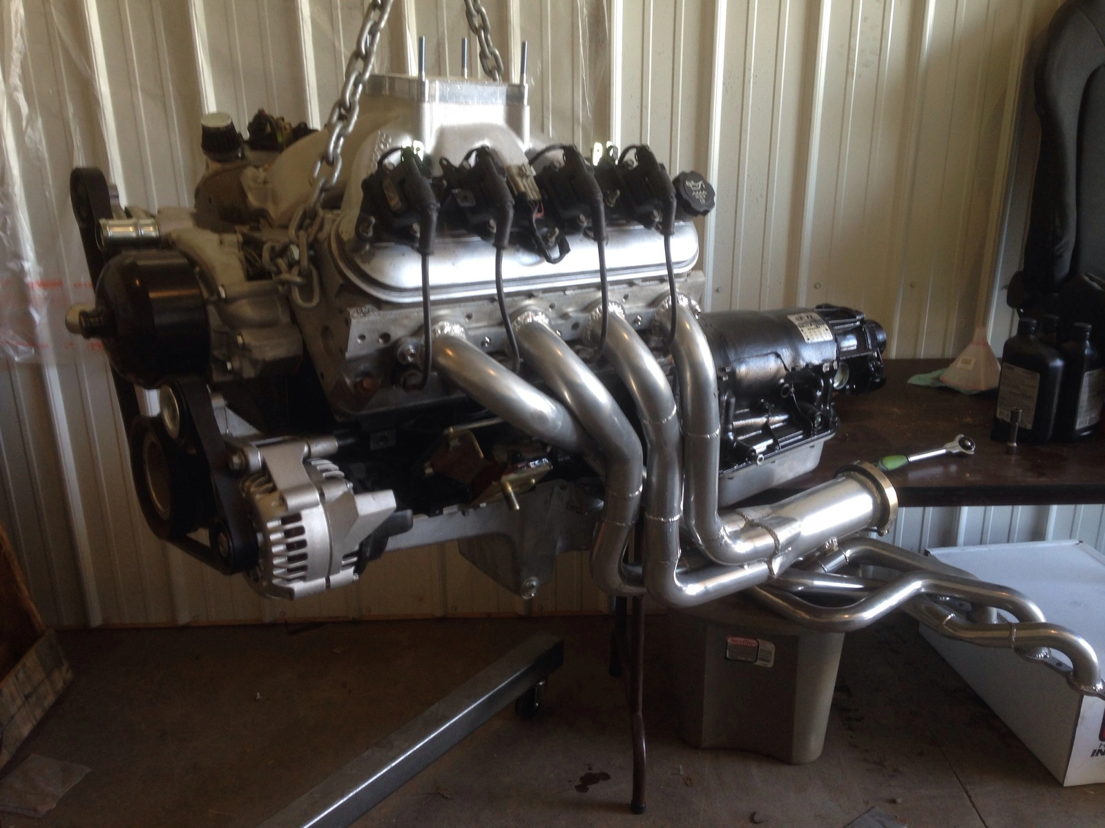

Currently the motor and transmission are in the car and the exhaust is finished. Car has been converted to manual brakes and steering. I wrapped up the cooling system the other day and got the car back on the ground. Waiting on my fabbed valve covers and the engine will be 99% finished. Just designed my fuel system last night and have tried to map out some of my wiring for the rest of the car.
I'm essentially waiting on a fuel pump, driveshaft, throttle body and my ECU and the car will drive.

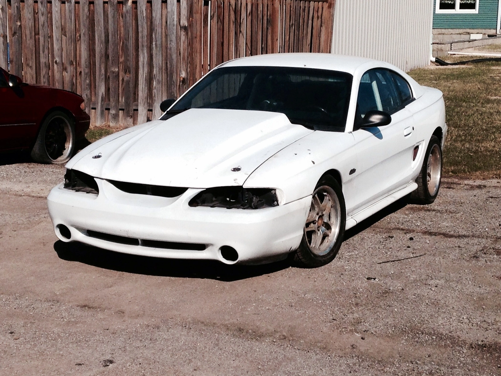

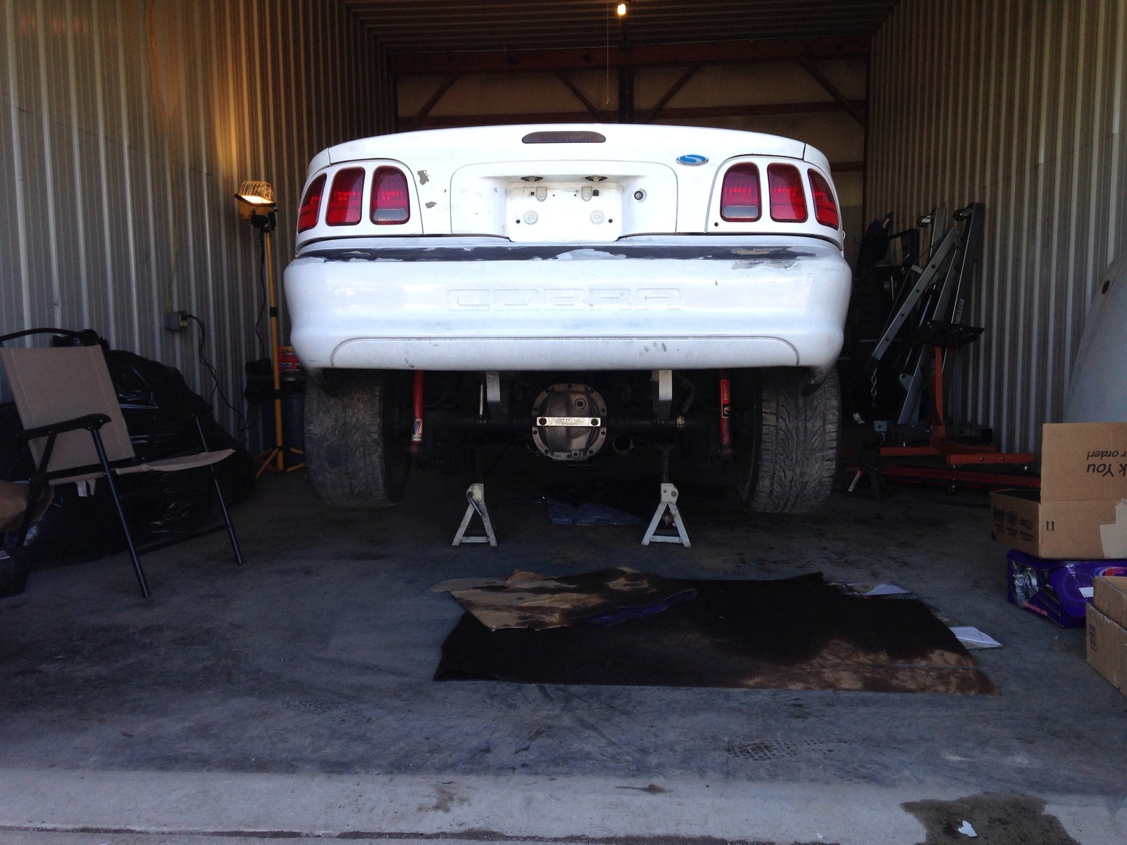

Bought some touch up supplies to try and temporarily fix the paint flaws. It's not gonna be a pro job by any means but I'm hoping it'll make me feel better until I can get the car an actual paint job.
Cars got OEM cobra bumpers on it, but unfortunately they weren't repainted correctly and as the bumper flexed the paint pretty well fell off. I chased the flakes and pretty well stripped the top of the bumper. Front bumper needs some love as well as a couple peeling spots. We're all go, no show orientated but it's still been eating at me.
I've got no experience with powdercoating wheels so I may just spray these anthracite to bring them back to life until I get the new wheels and tires.
Engine bay looks good and clean. What headers did you end up with? Did you still run the Holley system? I am not even sure PSI or Speartech make a wiring harness for that type of intake system. I also fancied the Holley high rise fuel injection system.
Holley HP EFI with the LS1 harness is what I'm going to be using. The headers are some one-off custom built 1 7/8th to a 3.5 collector. but I had originally planned for a set of dynatechs. These were built around an AJE k and were a PITA to fit.
