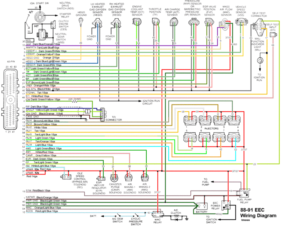

See the following website for some help from Tmoss (diagram designer) & Stang&2Birds (website host)
http://www.veryuseful.com/mustang/tech/engine/images/88-91eecPinout.gif

The wiring for the injectors may have some bare spots in it causing the injector to computer control wire to ground out. This would cause the injector to remain on anytime the key was in the Run position. Remove the injector wiring connectors from the injector. Note that each injector has one red wire for power and a non red wire (wire some color other than red) for computer controlled ground. With the key off, disconnect the computer connector from the computer. Use an Ohmmeter between the non red wire and ground. You should see more than 100000 (100K) ohms resistance.
See the following website for some help from Tmoss (diagram designer) & Stang&2Birds (website host) for help
Using the above diagram, check the resistance between the injector and the computer. Clean and check the 10 pin connectors since they are a potential trouble source. Any resistance greater than 1 ohm between the injector to computer wire and the matching pin on the computer connector is a problem.
