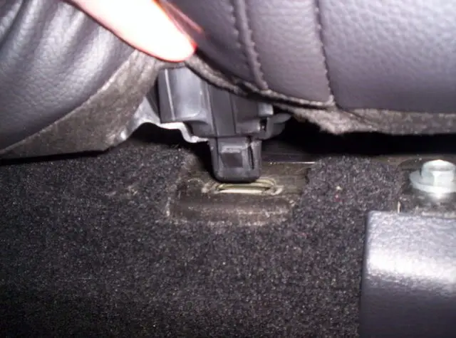

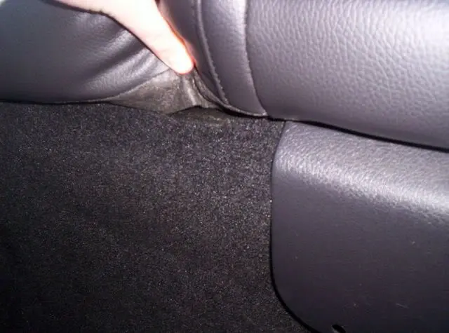

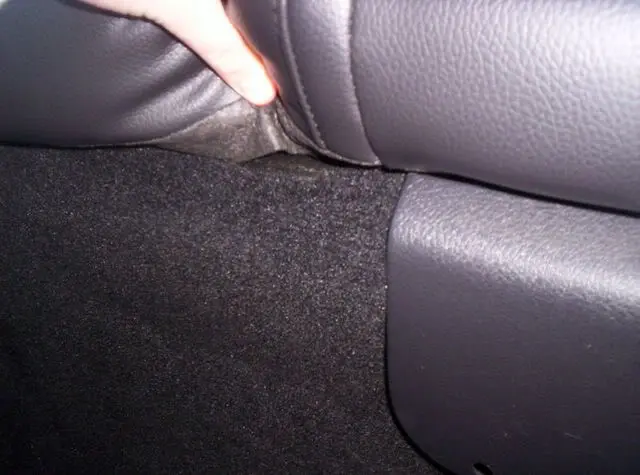

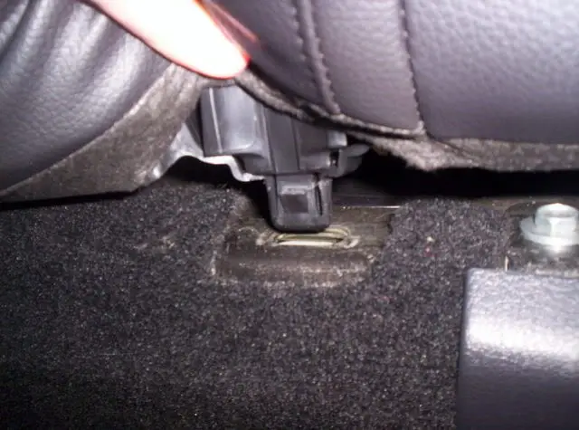

How do you remove the backseat in a 06 Mustang? I got some bad gas and I need to remove the pump and blow out the gas line, and pump the gas out!!!!!!!!! I guess a new fuel filter is a dealer only part? Thanks Gregg
at the bottom of the cushion, stick your hand about 1.5" in from the trim panel (where it goes toward the center of the car). reach in, and there is a small plastic clip to push in. push straight in, and then pull. there is one clip for each side.

Thanks
Many thanks for this info. A picture is really worth a 1000 words. Is there a fuel pump cover, or something under there? I have been wanting to install a Ford GT fuel pump.
under the seat is a large round plug. its just like a body plug or grommet, only larger. pull that up, and you have topside access to the pump.
