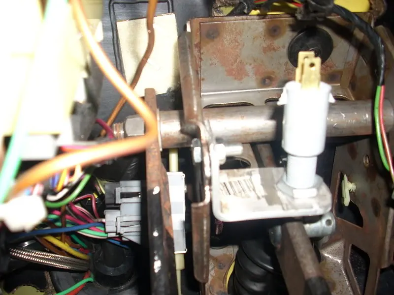

I run an Aerospace kit similar to 84Ttop's. The only difference is I have stock SN disk brakes in the back. This has lead to some trouble, but it's not going to be an issue with your setup since you are going to new brakes all around. The pedal effort is a little stiff, but not too bad with big brakes. It really sucks with stock brakes. I relocated the leverage point on the brake pedal. It's no fun to do, because in order to drill that pedal, you pretty much have to take the whole pedal assembly out. The factory stoplight switch will not work. I made a new bracket to mount a stoplight switch out of an 85' Camaro. It is on a threaded rod, so it has nearly endless adjustment, and it's like $3.
