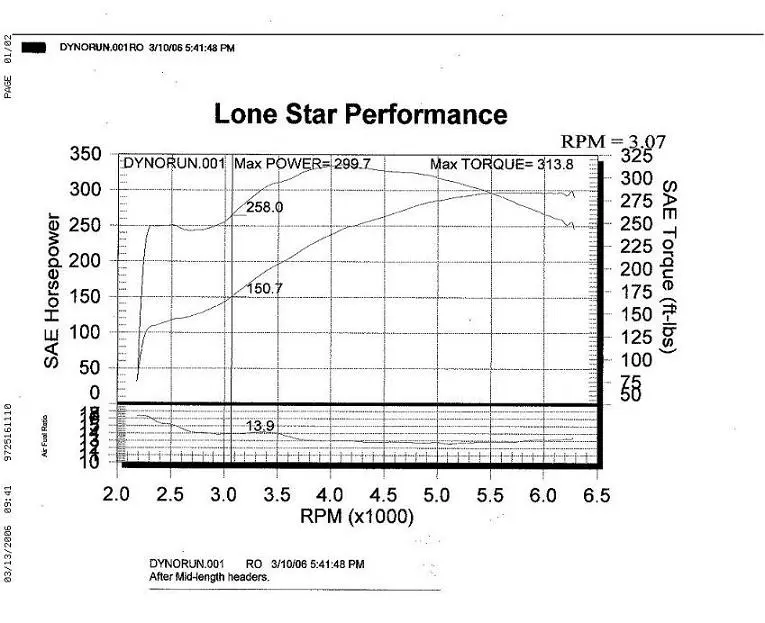

Okay, just got back from the shop....install and dyno pulls only...no re-tune.
Over my previous best these headers just made.. at peak.. right at 20 more rwhp and 14 mor lb/ft torque than my prv pulls. I know you want to see the sheet but my scanner is bad here. I can post those later but I just thought I would toss it out now because of all the discussion about these headers w/o any real world numbers to back it up...
Prviously w/o headers 279 rwhp sae, 299 tq....
Current numbers were 299.7 (.7 dangit) and 313-314 tq...
Mods
Bassani mid's
Bassani 5 pc x w cats
Magnapacks
JLT CAI
C&L MAM ( I know, I know)
75MM BBK TB
C&L Plenum
V/T Stage II Cams
NO HEAD WORK....
With 4.30's in the arse end.....
Overall VERY pleased....didn't think I'd see 20/14 out of it...

They were on different dyno's...both SAE #'s though and the weather was much worse yesterday than it was when I tuned it after the cam install....

Here is the dyno sheet....
I plan on going to the place where I got my tune and original #'s after the cam install this weekend to get the A/F touched up a bit...I'll get a pull there so we can compare apples to apples..

UPDATE...It's Saturday afternoon and I just got back from the dyno where I got my original numbers from...This time I came back with 298.9/306.9....
UNCORRECTED I put down 303.7/311.7....So there you have it...Pretty solid gains from the midlengths!

You lost power after you got it corrected?
