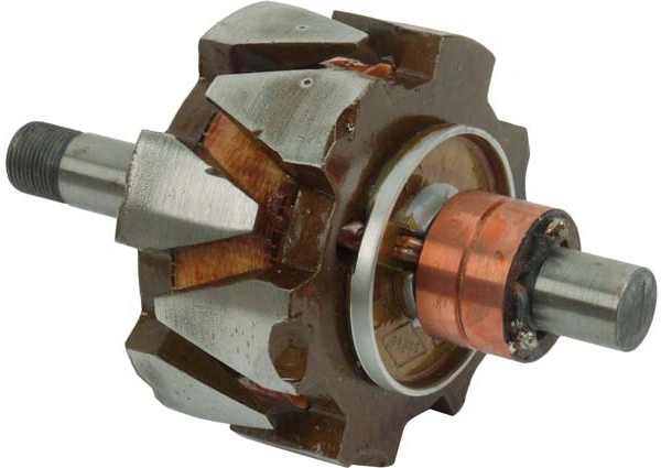

Your problem is a worn brass slip rings on the rotor assembly. After some miles, the brushes tend to wear a grooves in the slip rings, which causes them to make sporadic contact with one and other. This is why the charge light tends to go on and off intermittently. Very common.
How they're supposed to look....
How they look like when worn....
You can sometimes do it on the cheap if you can set your rotor up in a lathe and sand/machine down the high spots so the surface area is smooth again. Of course, that will all depend on how deeply the grooves are worn. Otherwise, you're in need of a rebuild my friend.
Sorry for replying so late. I am noticing that the battery light is start to become more common. Okay if that is the problem which I'm hoping is a simple swap out or something. How much would I be looking at for a new one? Would I be able to do it myself? Or would I have to take it to a shop for that specific issue? Please and thank you for your help
